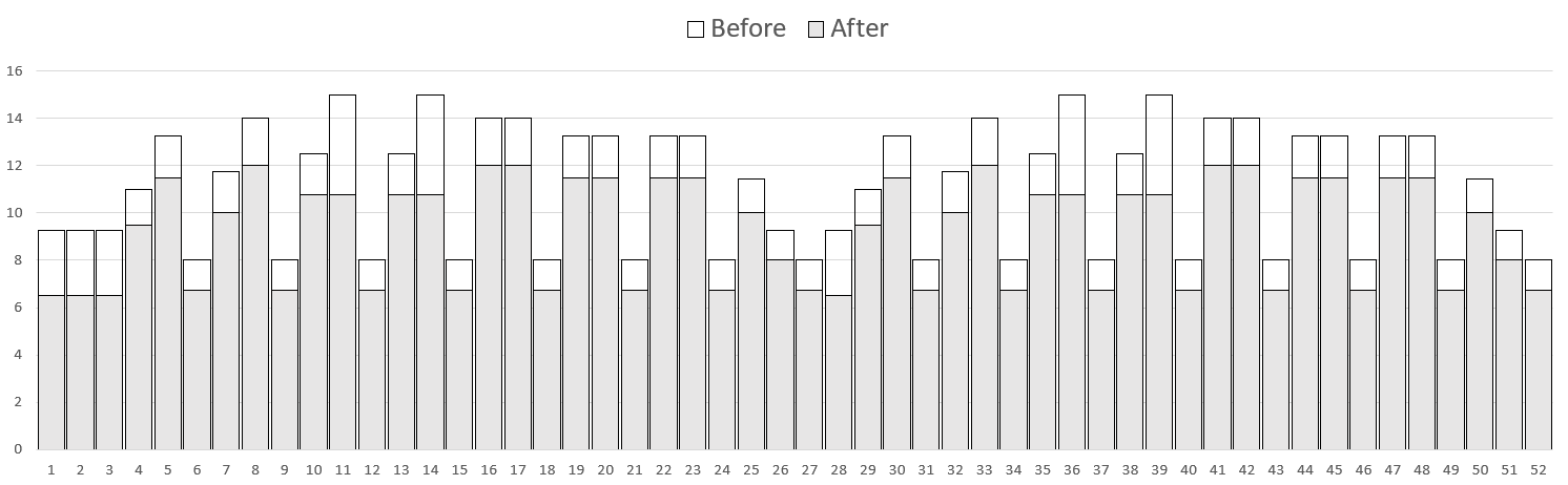

If your upper weekly time-limit decreased, then you need to drop the lower end of the weekly load too. At 12 hours you can peak at about 660-720 load. That means everything else scales down and you start at about 400 load.
Your two hard sessions can still progress in a similar way as the 14 hour weeks, while your endurance rides fill the balance of the time. Most times, someone dropping duration doesn’t want to lose enough fitness (CTL) to enable them to build up to the upper limit.
Here’s a graphical representation of how the load compares between 12 hours and 14 hours as the peak. You can see the progression is the same relative to the start and end of the plan.
The two graphs are a 3+1 vs 2+1 ratio of work+rest

Always in the grey zone is an indication that you find yourself at a plateau, meaning you no longer have time to progressively add more time/load. To ensure you have progression, your start point (01 on the x-axis) needs to be about 7 hours and you add more time each week, recover, progress more up to 12 hours.
Just because you have 12 hours available, doesn’t mean you have to do that duration every week.
