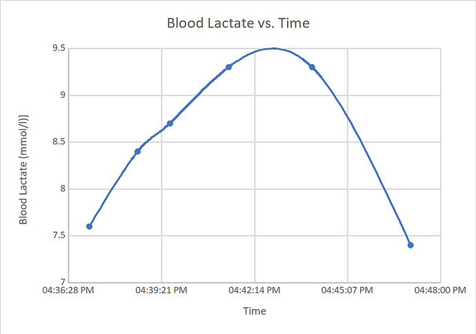

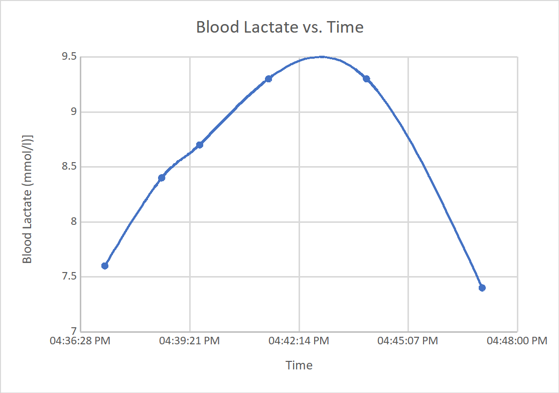

However, for the VLaMax test, I use anywhere from 6-8 points, so I typically do two pricks per finger (doing each finger once and then making a new puncture at least 5-7mm away from the original puncture). Here’s the data from my VLaMax test last weekend. This is data from a 15-second sprint effort.

I guess you took a measurement at rest and before the effort ? So it takes roughly 5 minutes for you to reach peak BLa ?
Moxy gives some additional data, but there’s no compelling research yet on threshold detection with muscle oxygen. I find that you need to use 2-3 Moxy sensors to be able to see how the whole body oxygen supply is behaving during maximal tests. For example, the leg muscles will dexoygenate during exercise, but a non-working muscle (e.g. the lower back muscles, triceps, deltoid) will only start to deoxygenate when the body is no longer in a quasi-steady state, or above “threshold”.
I measured VO2Max with my metabolic cart and you can also estimate it from the last minute power from the ramp test. For VLaMax, I take a lactate measurement after 2-3 minutes of rest (no pedaling) for the pre-sprint measurement. Then I take lactate measurements the first minute and every couple of minutes after the sprint, until I get a good curve.

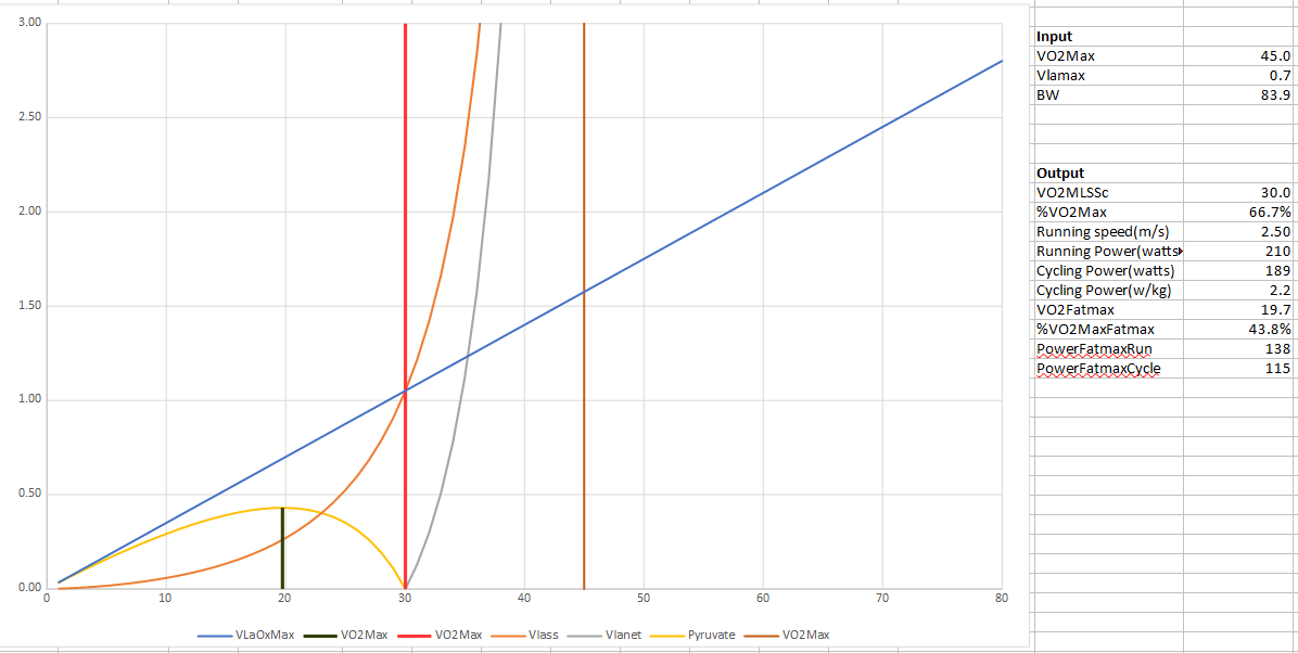

Check out Hauser 2014 - calculated vs experimental power paper. They describe the formulas to prepare the graphs and the constants used.
There’s also this python notebook that will give you an idea of how to perform the calculation. I just used LibreOffice Calc/Excel because I’m more familiar than Python. Python is the more elegant solution in my opinion.
Once you figure out the equations from Maders 1986 paper, you can expand and tackle his 2003 paper that I believe is part of the basis of Inscyds metabolic simulator. That one is taking me a while.
