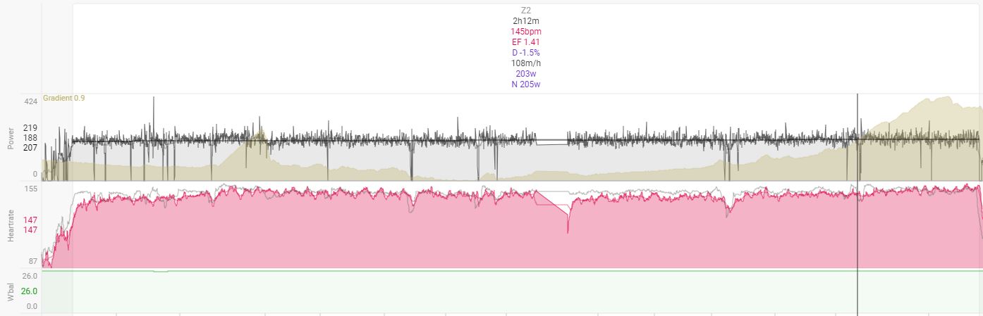

I have been experimenting lately with some very constant, top of Z2 training sessions. My idea was to select a flat course with as few descents as possible and hold the wattage for 2-3 hours with little to no pause.
This is what the power graph looks like:
hist
It is quite unintuitive to ride in this way, especially on (small) descents, where I need to hammer it to hold the ~200W. In contrast, on climbs I almost have to consciously hold back a lot to stay in the same zone.
The reason why I ask this question is that I almost suspect this session is too hard. There is no decoupling:
but, my legs feel quite a bit tired after 2-3h of holding the power. HR-wise, the average HR is 145, which is just at the edge of Z1 based on intervals’ model. Still, it is about 10 beats higher than when I was doing Z2 rides on the turbo trainer in winter @220W/135bpm.
Any comments are welcome :slight_smile:
No decoupling most likely means you’re pretty efficient at those watts. Increase duration or intensity.
Wouldn’t worry too much about the higher HR. So many different factors influence HR.
Z2 though is a big zone. Don’t neglect the lower Z2 / top Z1.
We’re you riding based on HR or Power?
What’s more important is whether it had any impact on subsequent sessions. If it did, you would be much better off dropping the intensity down and hitting the volume/consistency.
There isn’t much (any?) data to suggest that z2 training is more effective if you do it at your LT1 threshold.
Power. I take a look at the HR from time to time though
That’s valuable input. To be perfectly honest, I don’t have the time to train more that 3-4 days a week and so such sessions don’t really affect anything as I have enough time to rest. The reason I do it at LT1 is to get as high a load in that zone as I can in the fixed amount of time.

Interesting that your HR was quite a bit higher for the outdoor ride than for indoor rides with more power. For me it is the other way around or it must be brutally hot outside.
For HR i use the CTS 5 Zone model. In my opinion it represents a bit better the aerobic zone than.
The fact you show no decoupling on such a long ride suggests that this is not too taxing, that maybe you can even ride a little bit harder for your endurance rides. Comparing HR indoor to outdoor can be challenging but certainly 10 bpm is a lot. Maybe just do a few more endurance rides and see if it was just a day where your HR was elevated.
Are you relatively new to cycling? What is your cadence, too low? Both could be reason for your legs tiring, despite your HR saying the workout is easy for you.
Are you taking in any carbs on your endurance rides?

Cadence is definitely not too low, my guess is that I am not used to pushing on the flats…
And no, I have been cycling for 10 years now
Yes, but not much, usually one bar per hour roughly
Not even close to enough
close to enough what?
carbs per hour
