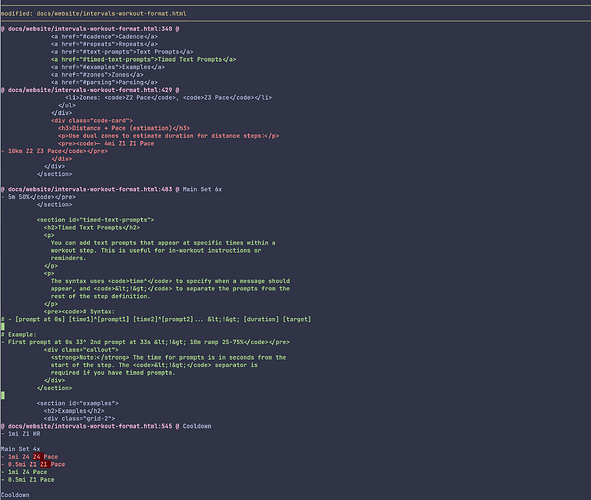

I’ve made this change to the page:
I’m also thinking about how to make this page collaborative. I don’t mind taking it out of the ZonePace site if it makes contributions easier.
Eventually as well, for the icu developers I want to publish a small parser library with a simple AST rule in JSON. That would give developers a clean structure they can parse and extend without guessing how the text should be interpreted.
