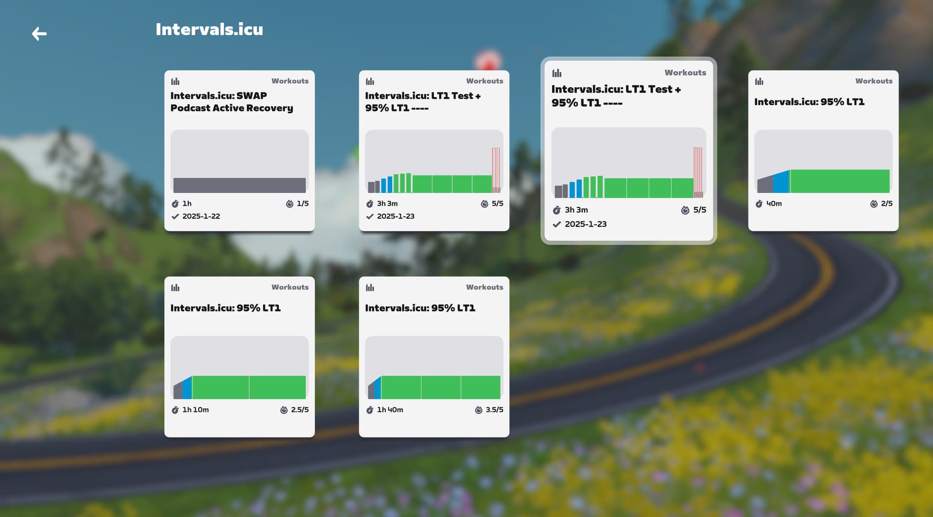

Hello @david. I was able to reproduce the bug not only on Apple TV app, but also on my Mac. First I created a workout and then copied to another 2 days in the next week. Then I edited 2 of them and added one 30’ block to the first copy and a two 30’ blocks to the second. Intervals.icu correctly reported to have uploaded the new files after the modification. And in fact, when I open the list of the workouts on Zwift, I can see the blocks added to the latest 2 workouts. See the first screenshot:

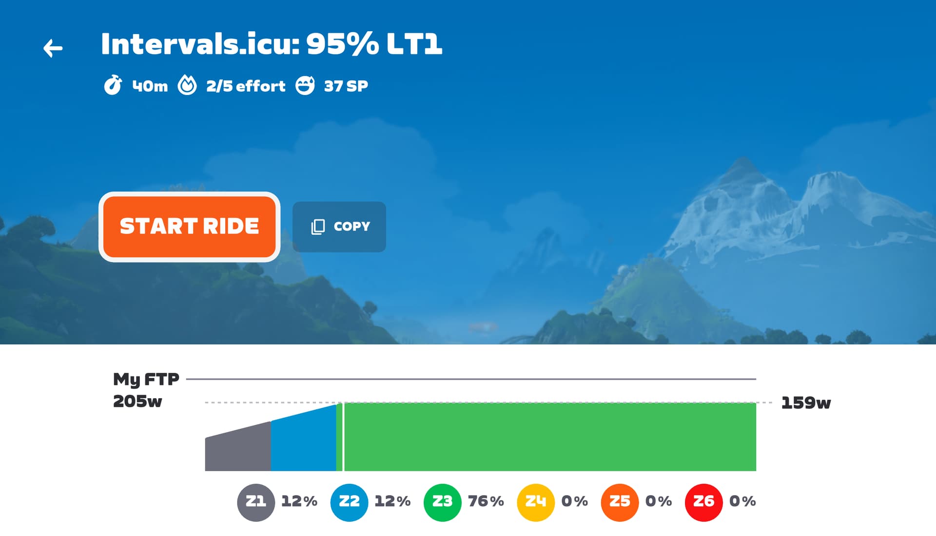

The problem is that if I open any of the 2 workouts with the added blocks I have the original workout without any block added. See the second screenshot:

Yes. The first screenshot is the intervals.icu folder and the second screenshot is when I double-click on the workout with 2 additional blocks. It’s the same also if I open the workout of the day from intervals.icu on the welcoming screen and it’s supposed to be the modified version. I get the same non-modified workout.
