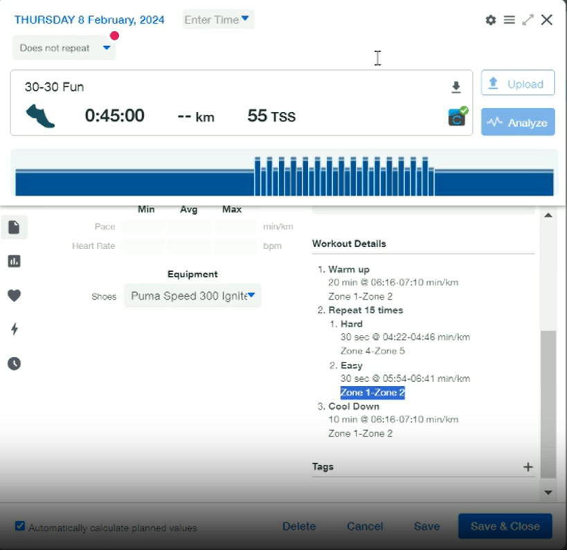

I think earlier I wasn’t able to communicate effectively what I meant. So I did shoot a quick video demonstrating what I meant here and if that is even a possibility. i know that might not be working like this at present but if that can be changed in the future.
Here is the demo of the question-
In TrainingPeaks you are using Pace as the measurement metric.
In Intervals you are using Heart Rate (LTHR).
These won’t give the same result as they are different units of measure.

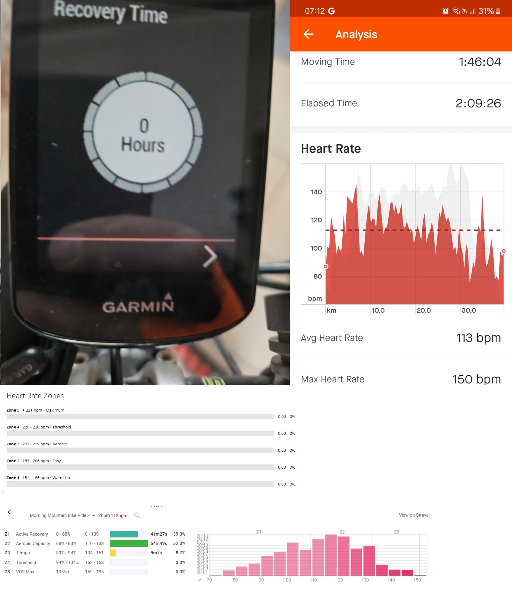

If I understand, your athletes are “lazy” and don’t update their zones in Garmin Connect.
I make a point of insisting that the athlete makes the change, otherwise I can’t load a workout on their calendar. When they don’t, this happens, and then they ask why the recovery time is zero.

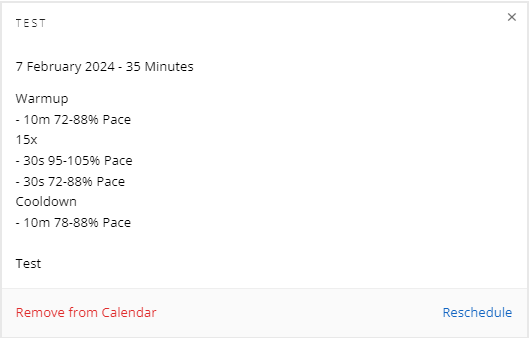

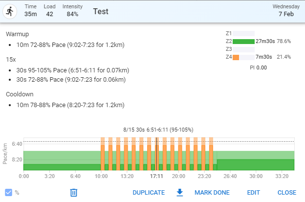

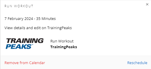

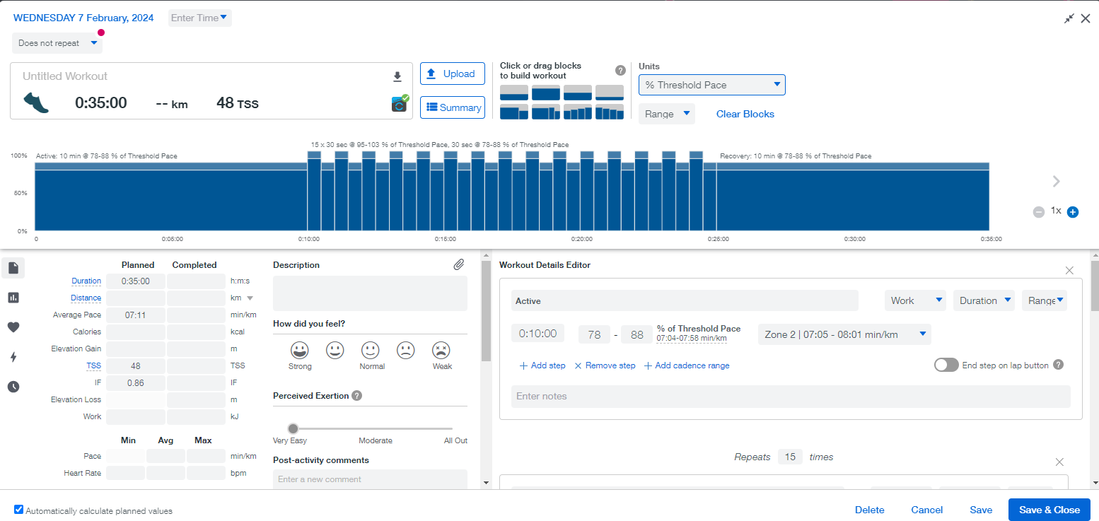

So, back to your video, here’s your TrainingPeaks workout (using Pace as the measurement unit).
I have replicated it in my TrainingPeaks calendar, to show you how this compares to Intervals.
My zones are identical in both apps. I used Z2 and Z4 under the pace settings.
Here is the same in Intervals.

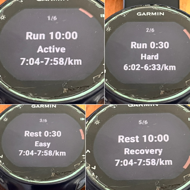

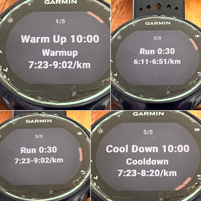

Then, in Garmin Connect I see both workouts:
On the device I see (TrainingPeaks on top, Intervals on bottom), and I can’t explain why it differs when the original apps are much closer:
