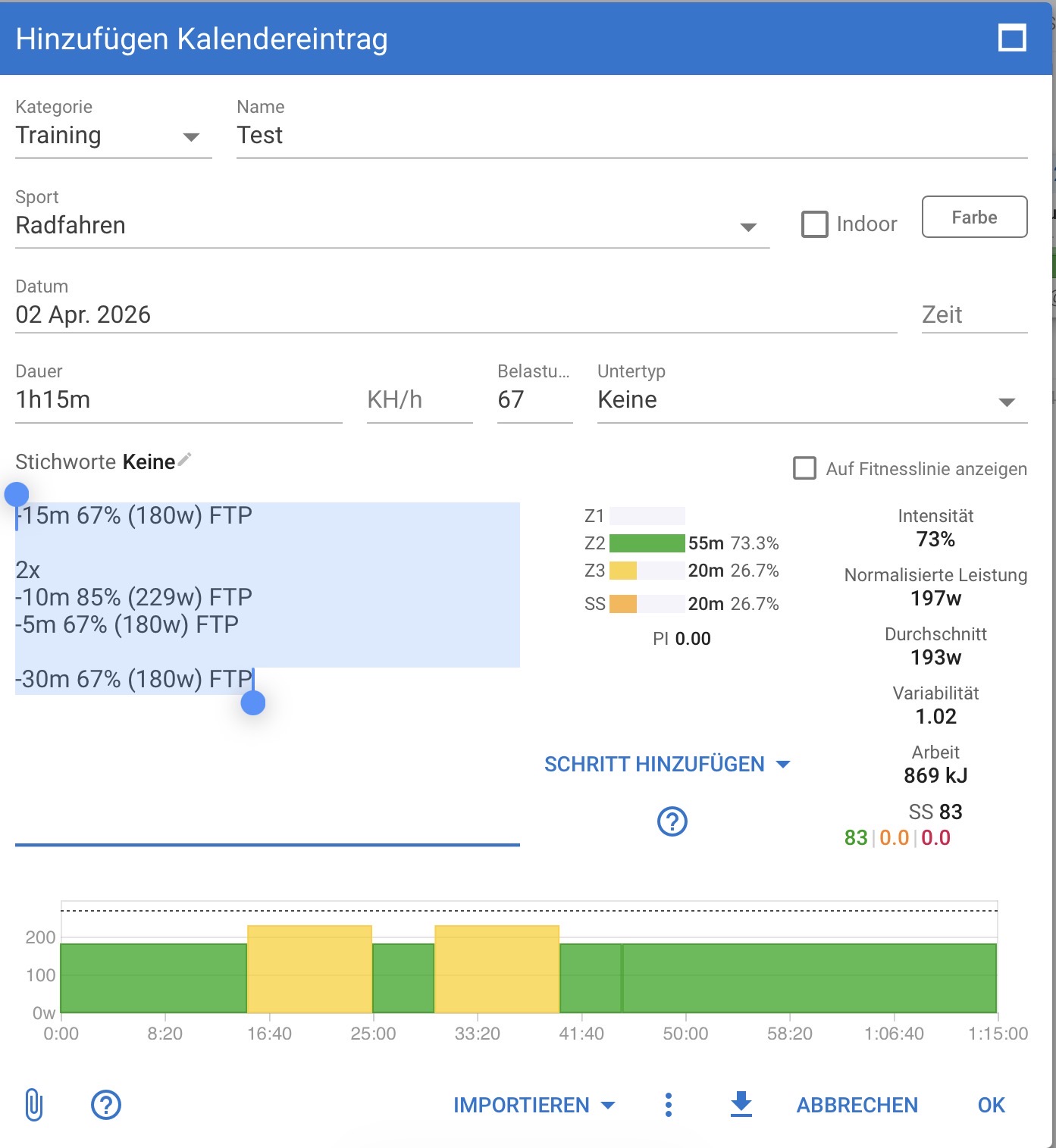

For the past few days, my interval workouts have been incorrectly transmitted to Garmin Connect, or Garmin is changing them.
Here’s an example workout:
  • 15m 67% (180W) FTP
2x
  • 10m 85% (229W) FTP
  • 5m 67% (180W) FTP
  • 30m 67% (180W) FTP

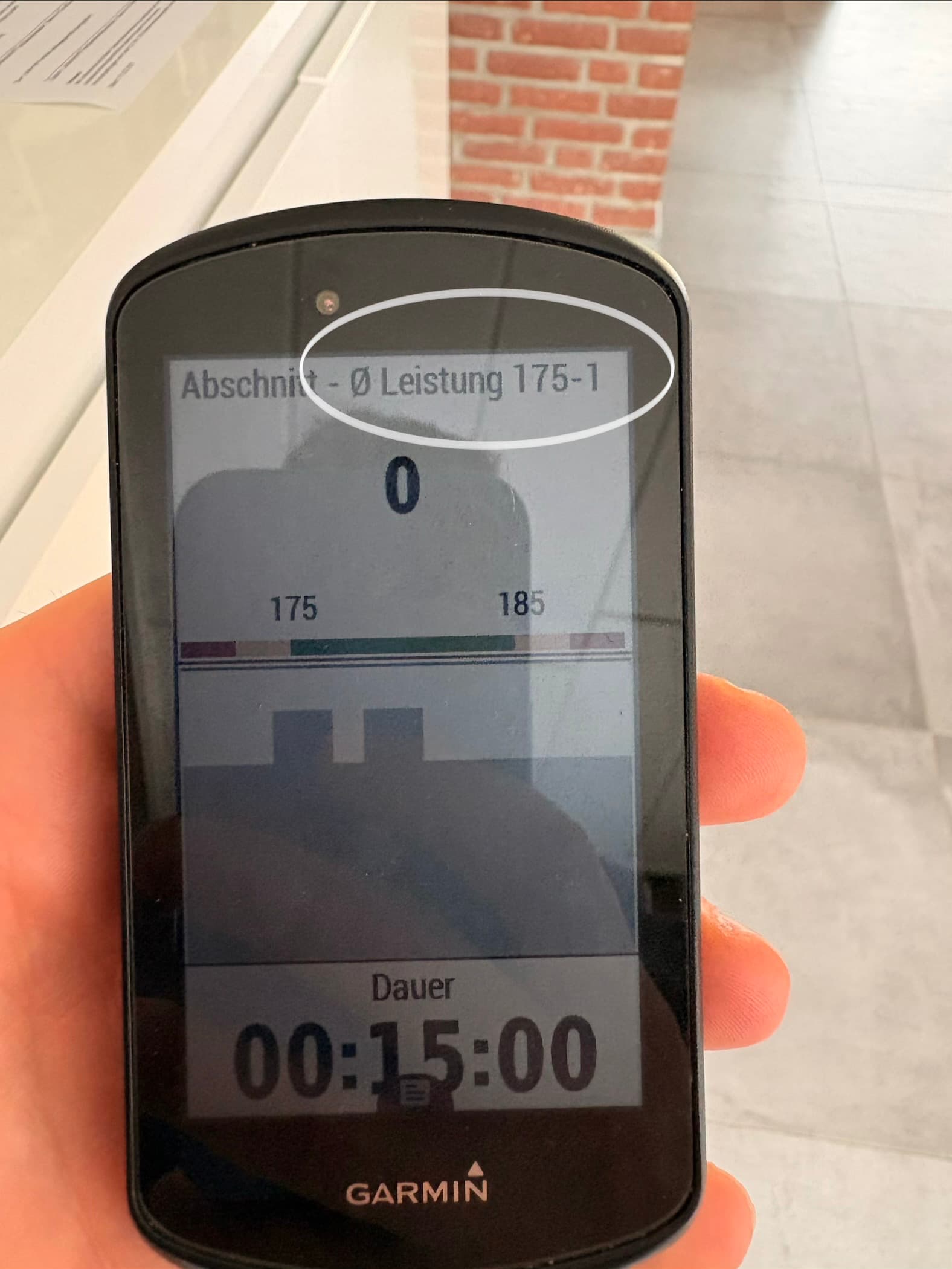

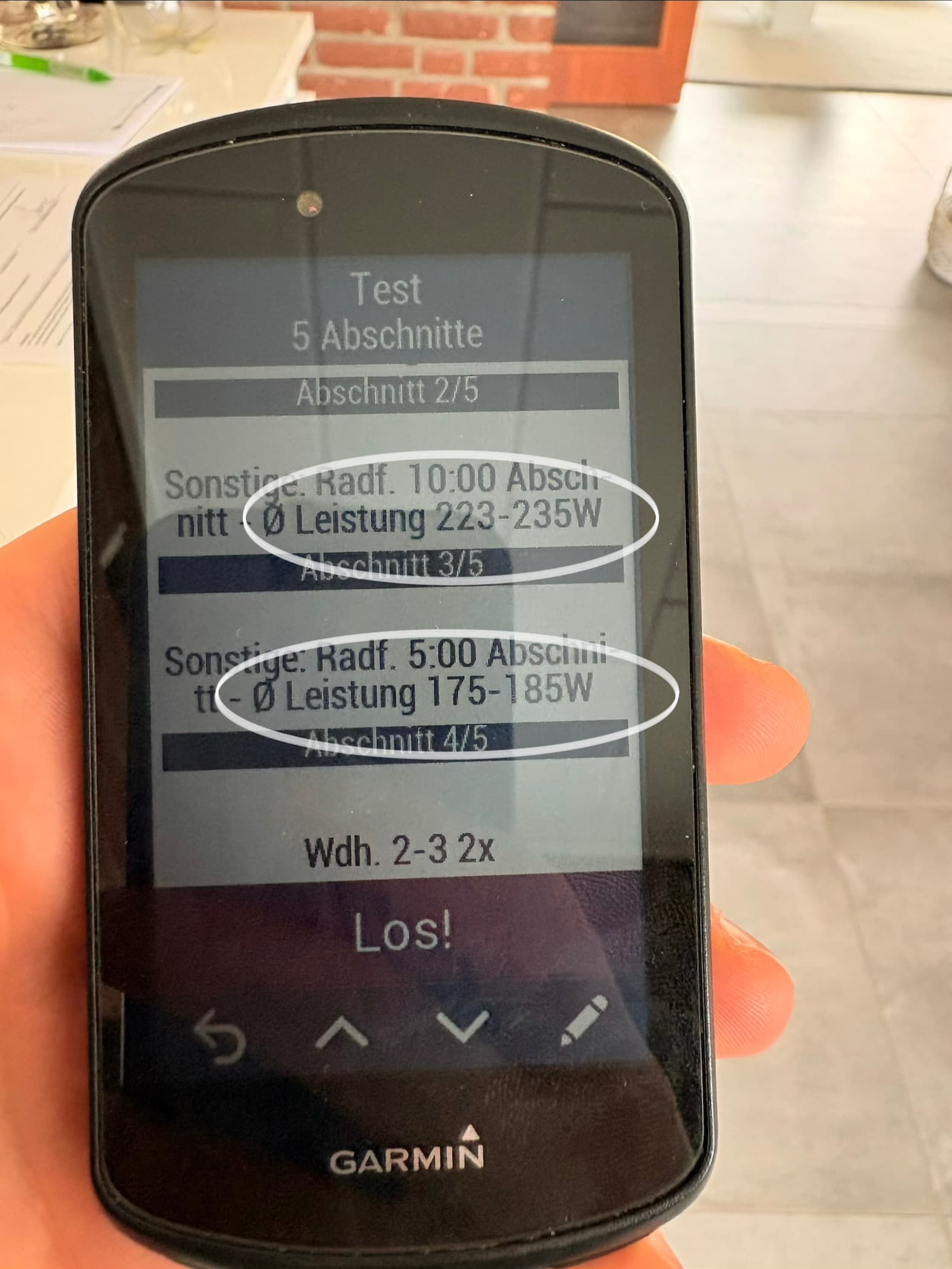

When I go to Workouts → Training Plan → “Test” workout on my Garmin device, the workout details are displayed. The following data is shown:
• 15-minute average power output 175-185W
• 10-minute average power output 223-235W
…and so on.
The problem is this: On the workout view (the data page for the workout - not configurable), I now only see the average power output instead of live power or 3-second power, which isn’t ideal in some situations.
