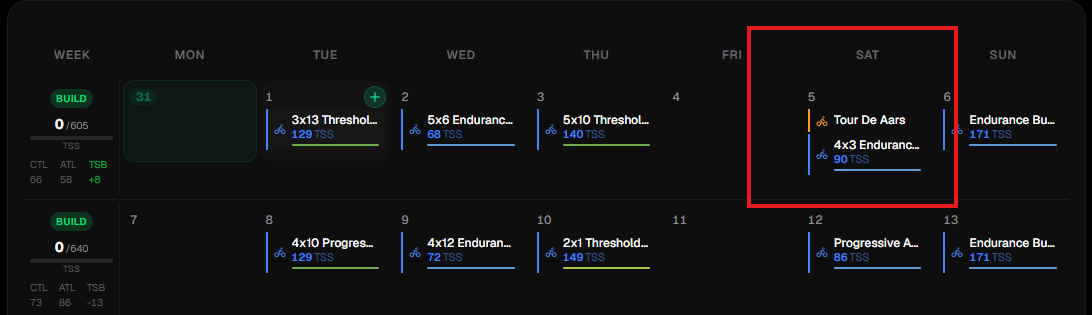

I added a C race to my calendar this saturday, but the training plan has not rebuild, and the training which was planned before adding the race is still in the calendar.
When can i expect the plan to “rebuild” around this? and should i have done something different when adding the race to my calendar.
I attend a lot of races and would like to add them into my trainingplan/calendar sometimes with short notice.
Also it does not seem like the TSS add up i the week with the race.
You did nothing wrong, and the race went in correctly.
Adding a C race is supposed to trigger a rebuild, and in your case it did. The rebuild fired six times this morning right after you added Tour De Aars. Every one of those runs read zero workouts from your calendar and so changed nothing, even though the sessions are plainly sitting there.
The TSS not adding up in that week comes from the same place. The plan is treating that week as if it has no sessions in it, so the number it shows you is not the number that is actually on your calendar, and the race load is not folded in either. I have been chasing this for a couple of days across a handful of accounts and yours is the clearest example I have, so thank you for the detail. I’ll get this fixed.

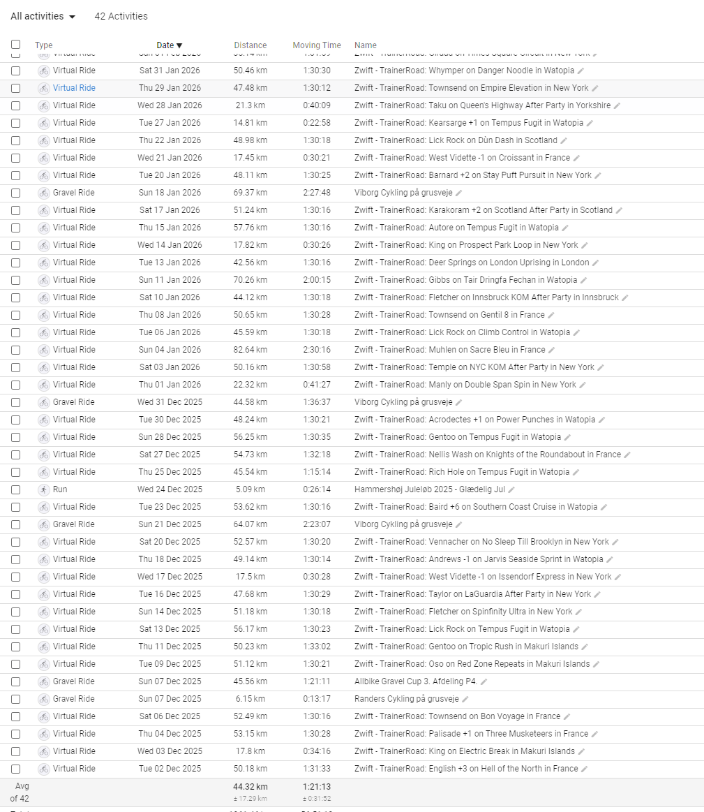

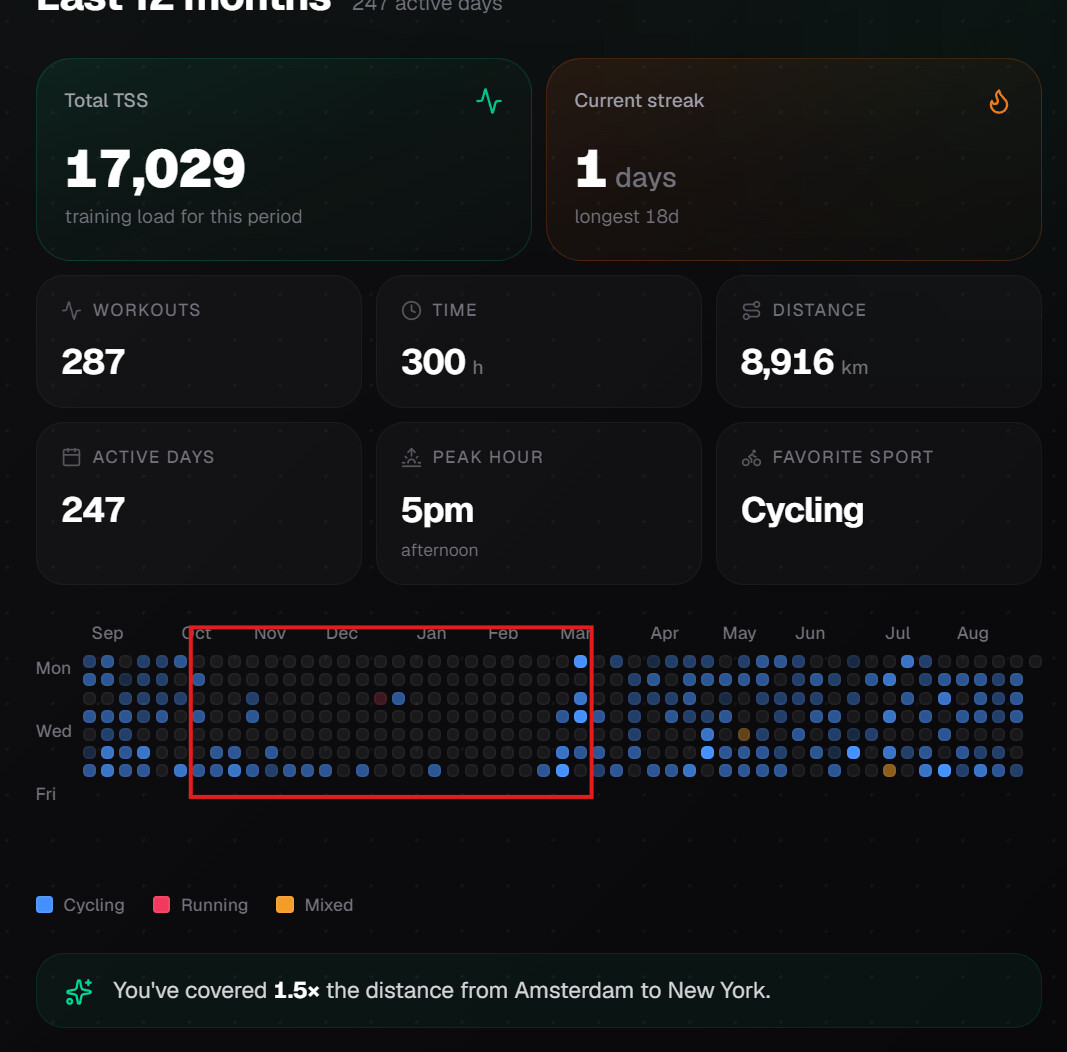

On another note i just saw that all my indoor training has not been imported, that also seems a bit strange.
Thanks, that is kind of you to say, and the reports genuinely help.
On the indoor rides: I had a look, and everything Intervals.icu holds for you has come across. Over the last two weeks that is ten activities, all imported and all analysed, with nothing sitting in a queue. Your sessions arrive through Garmin Connect, and the one indoor ride I can find is a MyWhoosh session from 20 August, which came in as a virtual ride and was analysed like any other.
So the ones you are missing are not reaching Intervals.icu in the first place. IntervalCoach only reads what is already on your Intervals.icu account, it does not pull from training platforms itself, so a ride that never lands there stays invisible to me too.
Worth checking in Intervals.icu whether those indoor rides are there at all. MyWhoosh needs a route in, usually through Garmin Connect or Strava, or by uploading the .fit file yourself. If it turns out they are sitting in Intervals.icu and still have not shown up on my side, then it is mine to fix: give me a date and a session name and I will dig into that one.

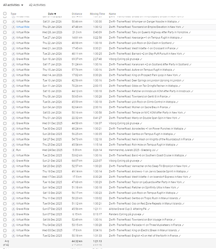

As you can see from the snapshot i have indoor rides almost 4-5 days a week the whole winter.
But they also seem to come from trainerroad - trough strava. Maybe that is the problem.

Strava’s API terms stop Intervals.icu from passing Strava-sourced activities on to third-party apps like mine. So a ride that reaches Intervals.icu through Strava sits there looking completely normal to you, and arrives on my side as an empty shell: no power, no heart rate, zero TSS. Those get skipped, which is why they are invisible to me.
The ten activities I could see over the last fortnight were the ones that came in by a non-Strava route, so “everything has come across” was only true of what I am able to see. Your MyWhoosh ride on 20 August went through fine, so indoor riding is not the issue in itself. The TrainerRoad ones are the category that arrives empty.
Worth sorting out before the indoor season rather than in the middle of it. Fuller explanation here: Strava activities: why some rides show no data in IntervalCoach - IntervalCoach
