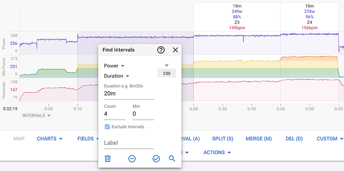

Is there anything that can done to improve the ‘find intervals’ feature?
See the example below. It’s something I regularly encounter.
I requested from the ‘Find Intervals’ function that it locates a 3m interval. The first 3 minutes of the ride are clearly a distinct interval (marked A) but the interval found is clearly part of another larger 10m interval (B). I can see no way to easily find and highlight the 7 distinct intervals seen on the screenshot below. I’d have to go and add 7 intervals and edit start and end times of each. Thanks.
Similarly in the same activity, I request that a 20 minute interval is found (obviously between points C and D), but it’s detecting a 20m segment (marked E) which includes an entire 10m segment and part of a larger 15m segment.
You need to start with the longest, highest power intervals first and use the “Exclude intervals” checkbox to avoid selecting existing intervals:
Bingo! That works a treat. Thanks :wink:

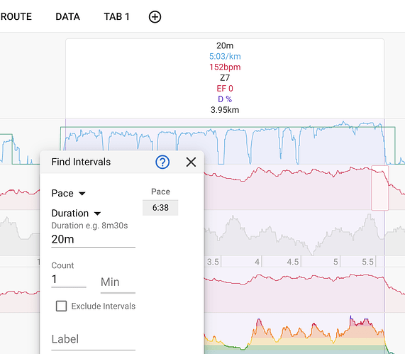

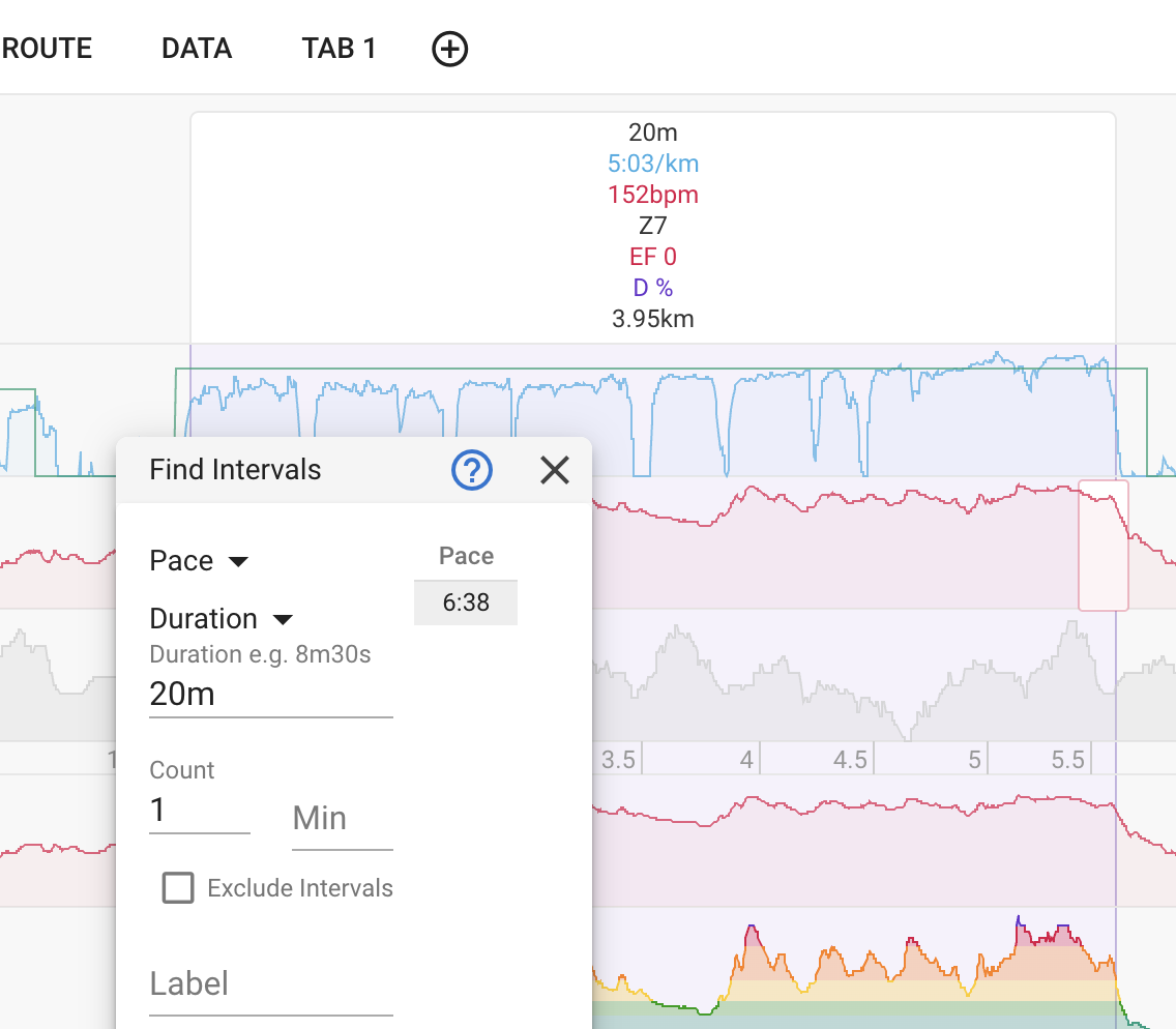

@david please, can you help me understand why the intervals found show a different value than the interval field? Example in the screenshot. I see 6:38 in the pace found but 5:02/km in the interval field.
In case needed, activity id is: i103970848. Thanks!
