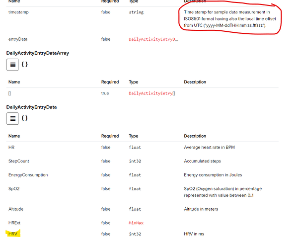

Not yet. I did poke around and they do have API endpoints to return some wellness stuff. But all the times etc. are in UTC which is a huge pain. You want local dates for this stuff. I need to know “how much did you sleep last night” on the day of 10th Nov 2023. Can’t do that with UTC data. I would have to assume the data is in your timezone as set in /settings but what if you travel?

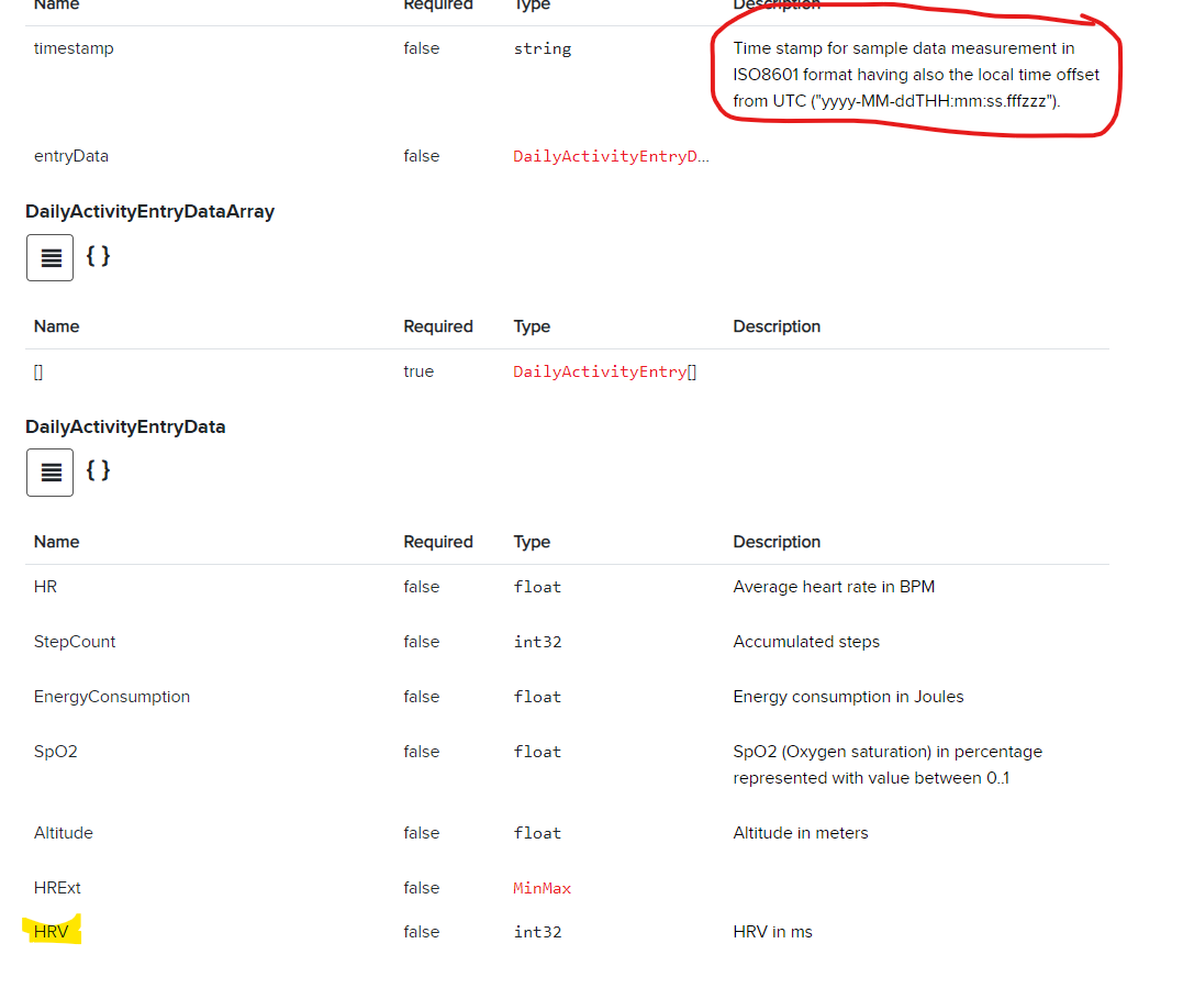

I had a look at the API page and it doesn’t seem to include the HRV data but hopefully, they will include it as they are adding it to their watches now but at least it has sleep, HR, and steps.
Nick
@david It looks like the Suunto have updated what you can get on the API
HRV now seems to be included and they use proper ISO 8601 time stamps, including the time zone Z for UTC
