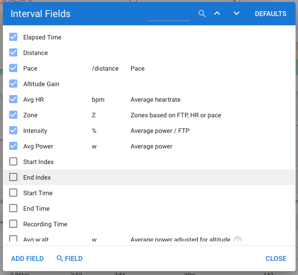

Hi there, I configured my charts to display the “Altitude Gain” field:

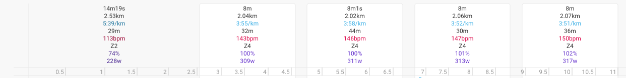

My last run has some segments, so for each one I see the altitude gain of each segment:
(I see the same data in the table visible in the data tab)

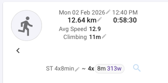

However, this run was done in a mostly flat area, where I get 10m elevation at most:
I’m a bit confused now: the total climbing (11m) looks correct to me, and the segments look wrong (as they would add up to 171m). Unless the two values are for totally unrelated things?
