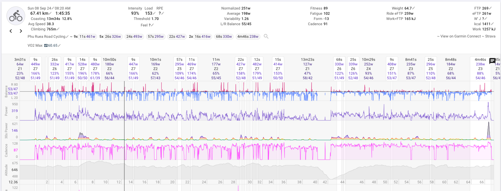

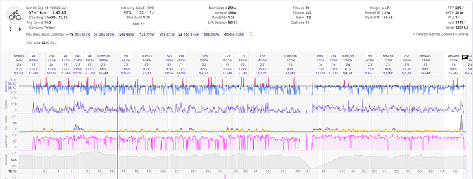

Hey folks,
Had a great race this weekend. In the final minute of the race I was able to put down 6.7 watt per kg. Not a great number but it was a hard and somewhat hilly race with 2500 feet of climbing over 67km , My max all time best 1 minute power is about 8-8.5w/kg
I will train more endurance and more 1 minute efforts. But should my focus be on improving 1 minute effort or improving endurance? I really didn’t feel great going into the sprint.
Both! You fresh 1 minute power is pretty decent, but you’re failing to hold on to that once you’re fatigued. One of the things I would be focusing on is building your fatigue-resistance by increasing your endurance, but, I would 100% be including some pre-fatigued sprint sessions into your training schedule to mimic the demands of your racing.

What average power is required to get to the finish before the sprint, and what is the duration of the event? It’s certainly not high zone 2 and/or low tempo, but also up to threshold.
