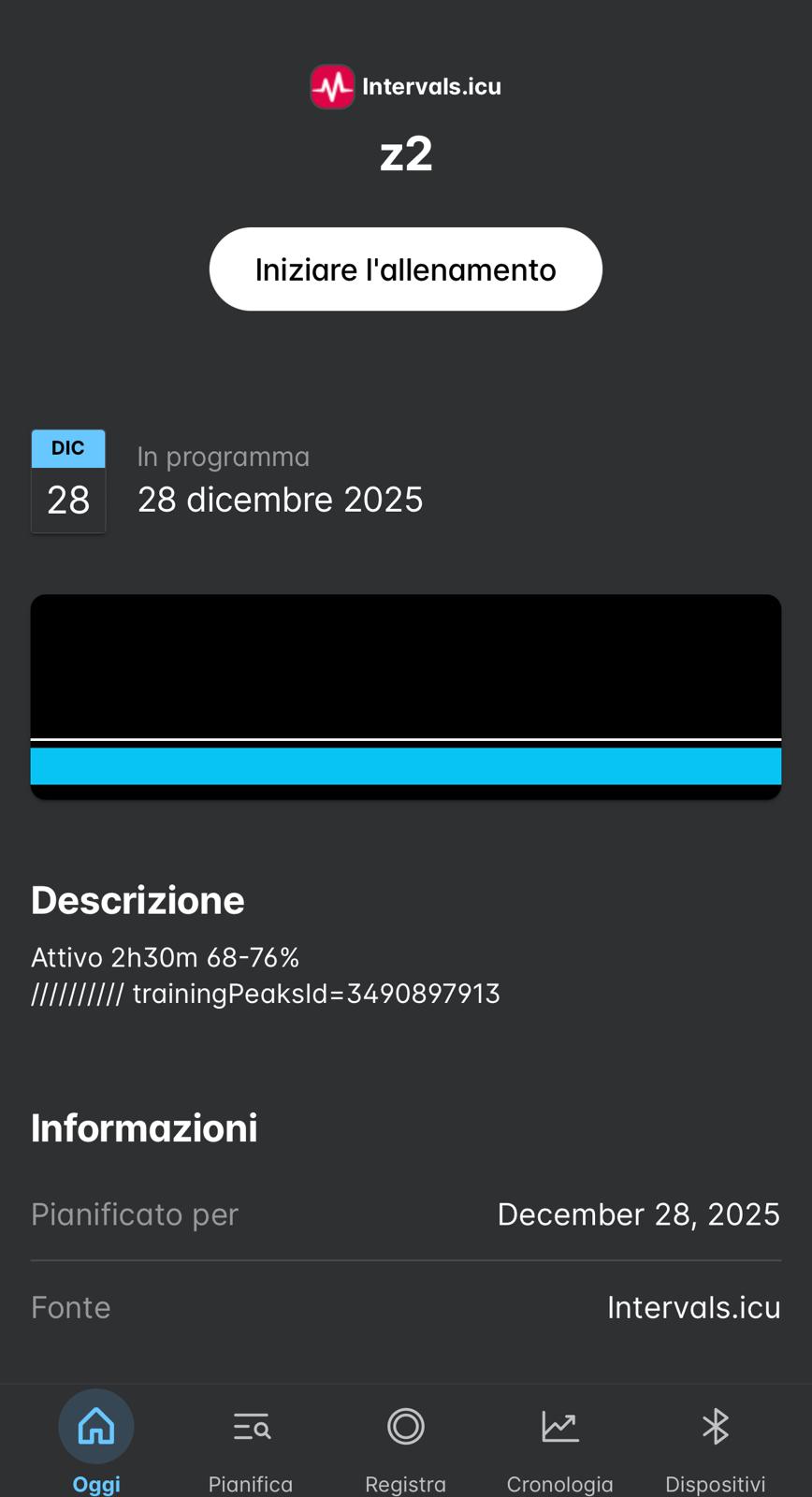

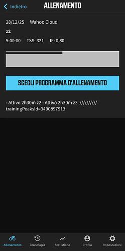

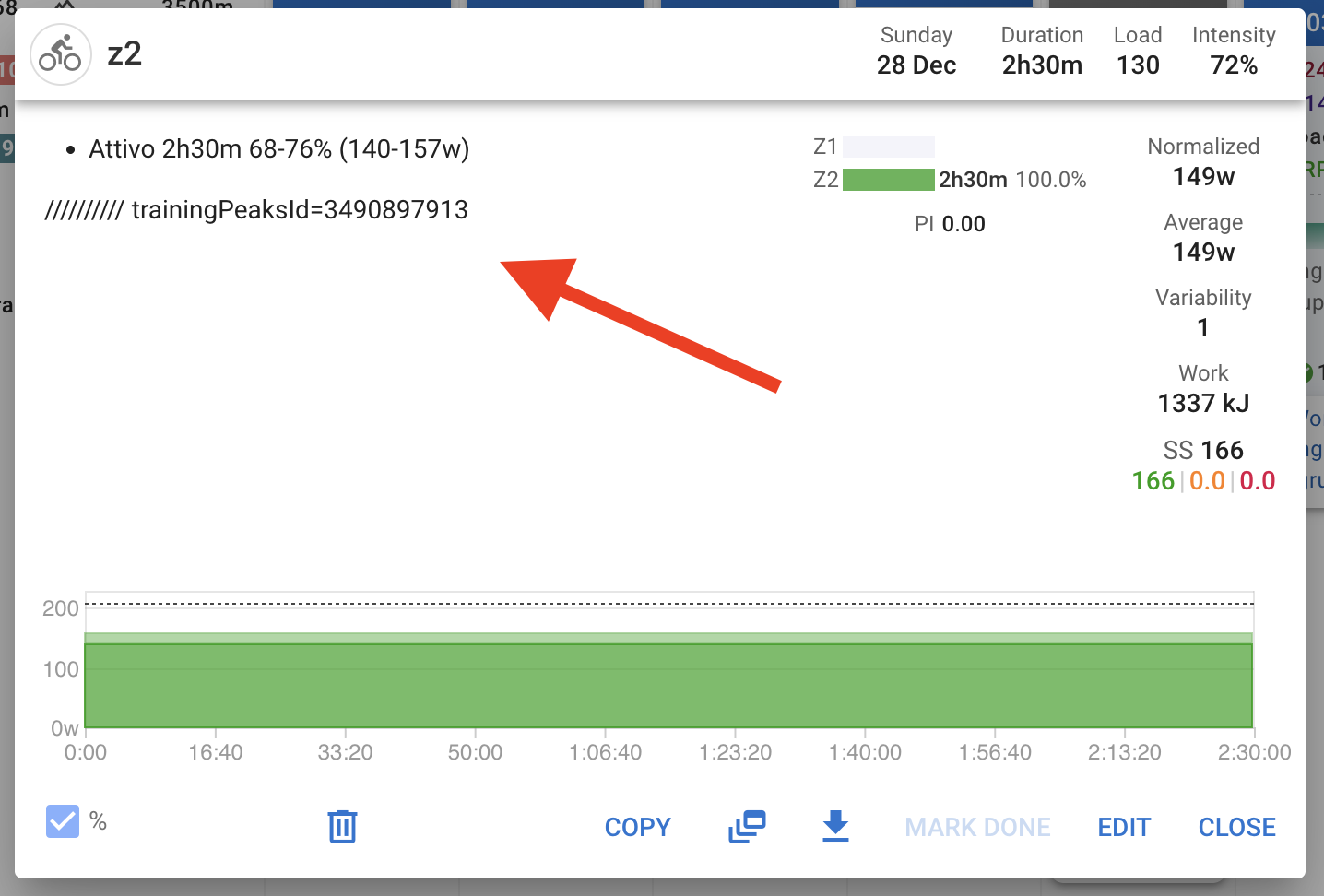

I’m having a problem with the poorly formatted description that Intervals sends to Wahoo Cloud
See the attached image.
This is a problem with how the description is sent to Wahoo Cloud or the way the description is set in Intervals?

I can provide more information.

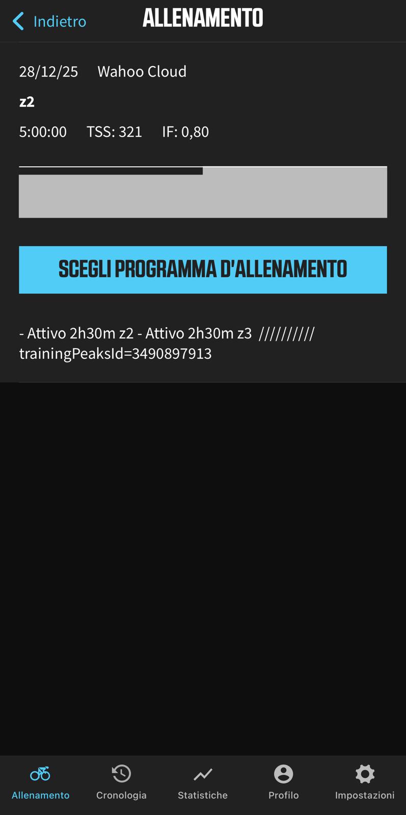

1. App Wahoo ELEMNT
screen Workout - ok
details page - Ko

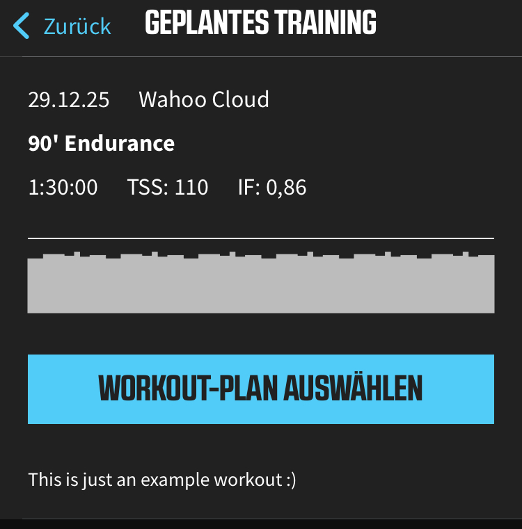

2. App Wahoo
screen Workout - ok
details page - ok

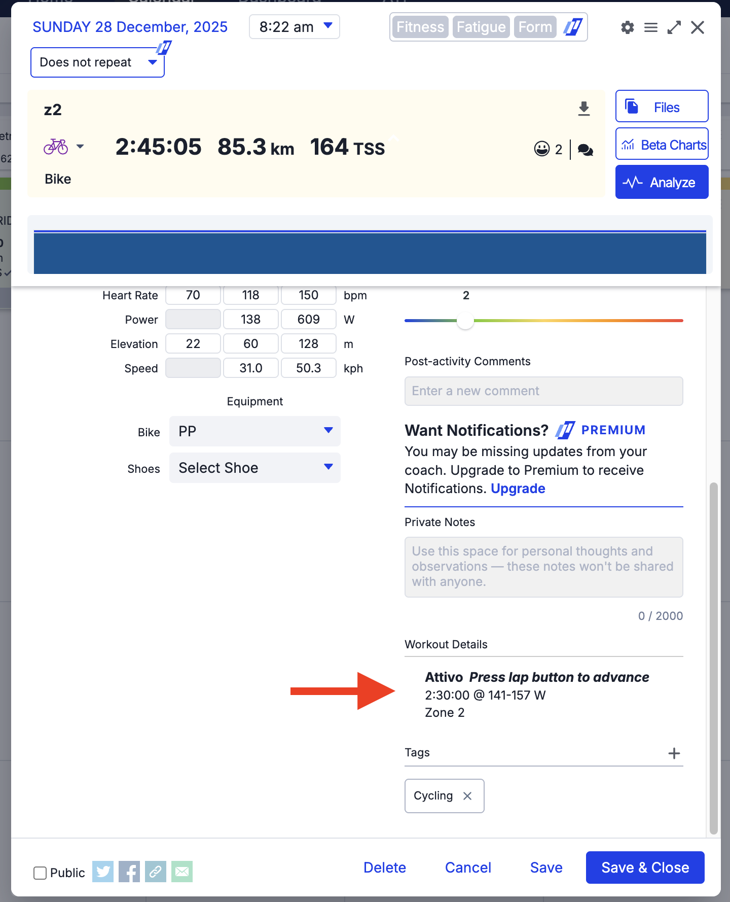

3 .TP
4 - Intervals
Some of the ELEMNT details page Workout has this bad formatting.

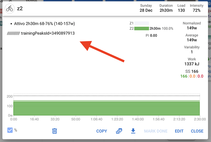

I am not sure what you mean. It’s the same description as in intervals.
There is also no official TP integration, so no clue where this workout come from. That’s probably the problem.
You can remove the //// and traningsPeaksId, and it should look better though.
Let me explain better:
It all starts with TP. My coach puts my workouts there.
With the tp2intervals tool, the workout is copied (and automatically these ///// and the trainingPeaksId are added to the description).
Then, Intervals sends this workout to my Wahoo Cloud.
So, when I turn on my Wahoo device, the workout is there.
However, in the only Wahoo ELEMNT mobile app, this description appears incorrectly.
Got it. Thanks for the explanation. Now I see that it’s 5h long in Elemnt App. And that’s really strange, because the source for this is Wahoo Cloud, same source like for the Wahoo App, and there it’s working. So that seems like an Wahoo Bug.

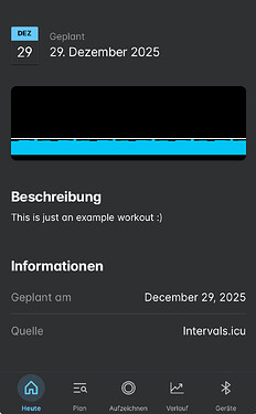

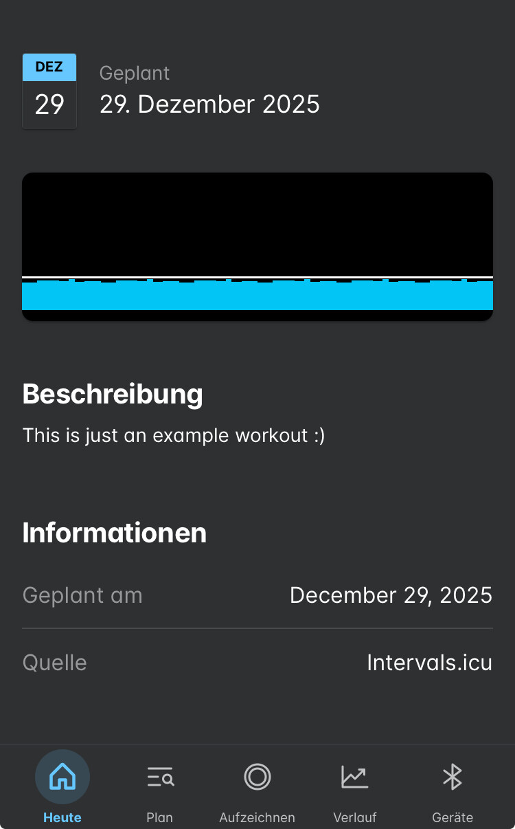

I’ve tried to reproduce this, but for me it worked fine. I’ve rebuild your workout and it shows just fine 2h30m in Elemnt App.
What happens if you manually edit something in the workout on intervals site (e.g. edit or remove the comment)? This should trigger an re-upload. Is it still the same? Maybe there is some setting missing (FTP?) in the Elemnt App.
