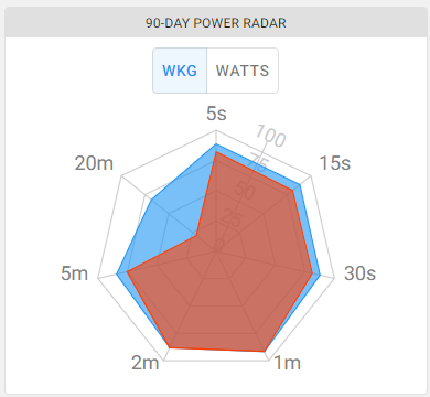

This picture shows how I compare with other Level5 riders in ZRapp in wkg (red is me, blue is everyone else in L5)

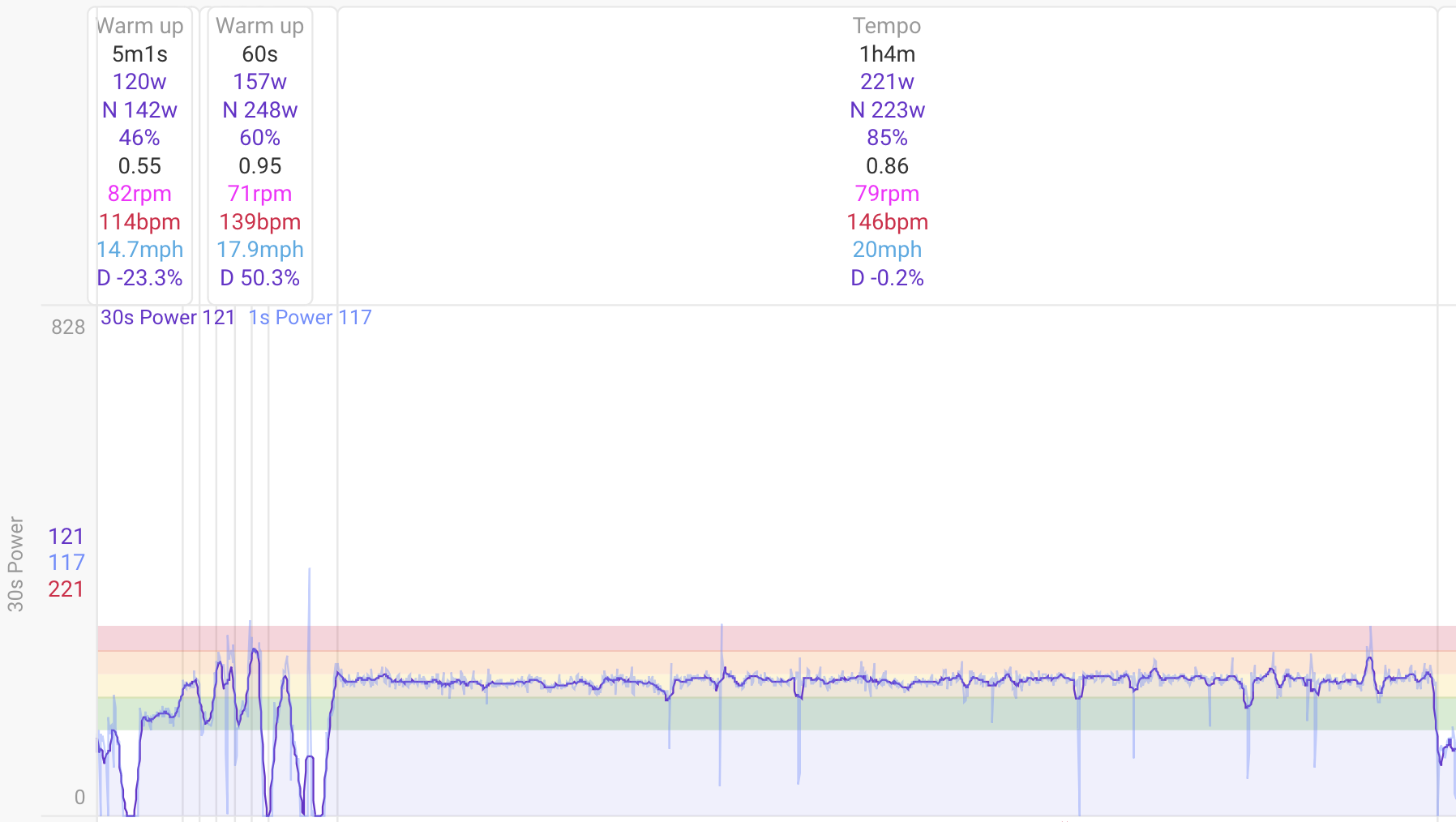

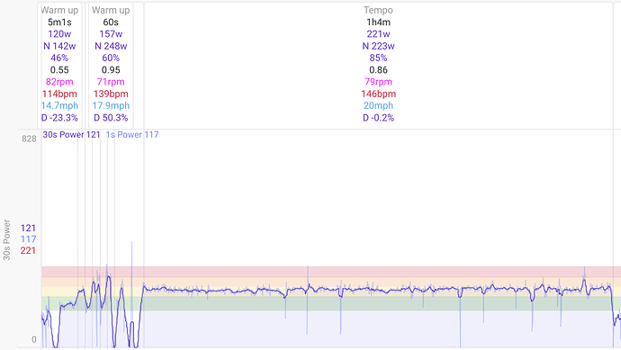

Our local Wed Worlds are flat but windy, about 45-75 minutes of threshold with a lot of punchy big power bursts when you rotate to the front of the echelon and put your nose into a gusty headwind. Or tailwind, where you lose the draft effect, trying to stay on wheels at 30mph. When I got fast enough to hang with the A group, it was because I was able to do somewhat punchy 2x30 minutes at threshold IF. Never looked at aerobic decoupling.
My “not a coach” bias is to use structured training to work on longer threshold efforts. If not racing, and in a build, that would probably look like 2 easy endurance days (1.5-2.5 hours) and 3 interval days with a mix of tempo, threshold, and above threshold work.
To your point about decoupling, personally I would look at a long tempo effort. After an off-season break (2-4 weeks), and 2+ months of base, my expectation based on experience is that I should be able to easily finish a 1x60-min steady effort at 85-90% ftp, here is one from earlier this year:
and see less than 3% decoupling. That one had zero decoupling (-0.2%).
HOWEVER, those efforts are really about muscular endurance to support doing harder threshold efforts for 45+ minutes. And less about decoupling.
So if I had your ftp and data, personally I would target 180-190W (85-90%) on a flat Zwift route (and NO erg) for at least an hour and assess two things:
  • did it feel like a moderate effort that required focus but not hard although I was happy to finish at 60 to 70 minutes (depending on my outdoor route). If I had to struggle to finish its time to do more tempo intervals
  • casually look at decoupling and be happy with anything under 5%

I am unfamiliar with the ZRapp heptagon you show and could not find any mention on a cursory search of the internet. Time is obviously one scale, but what is the 0, 25, 50, 75, 100? Is that showing that you are in the 25th percentile of your group in 20 minute power?

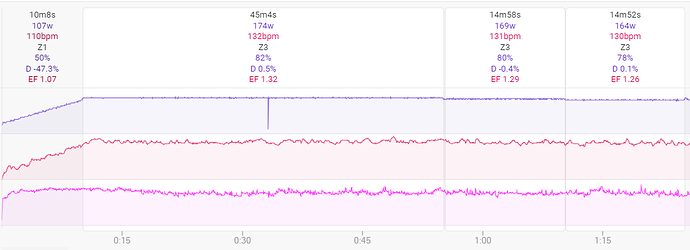

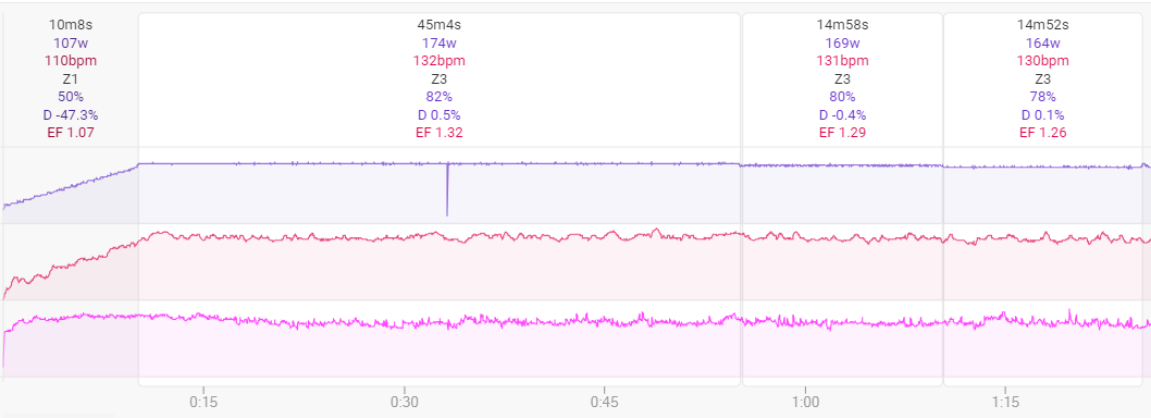

This is my last test done 24/8 with first 45min at 175w. I expect that my next test I will crack at 180w, or at the test after at 185w. I noticed that after 20 min, I had to focus on not having the cadence drop down.

zwiftracing.app is a race ranking platform that only considers race finishing results and no FTP or other wkg data. Also based on your phenotype they have some kind of handicap system
It shows that compared to other L5 riders (L1-L10) “the red parts” that I am relatively strong vs other L5 riders in the 1-2 min, doing OK 5sek-30 sek, and that I am terrible after 2 min.
Myy bad 20min (47,4%), relatively to the L5 riders. I am basically surviving the harder races due to my punch capacity that I can cling on to someones wheel, unless they push +5wkg for +2 min, then I am dropped.

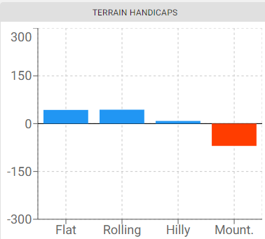

With the handical system it looks like this. Even though I am light, I am not good at Hilly terrain in general and Mountain terrain in particular.

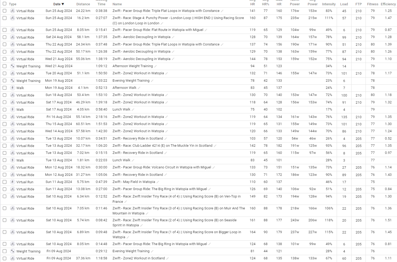

Short progressreport:
My focus on more volume on Z2/Z3 since early Aug seems to pay off and my body seems to respond fairly well. Maybe because I have not done this kind of training in the past.
Last week I raced up Zwift box-hill and increased FTP from 209 to 219 watts.
2 days later I did another Zwift race “Muckle Yin” and increased FTP again from 219 to 230, so now I am at 3.8wkg, getting closer to my target of 4wkg.
Today I also did my 45min at 185w. The fun part is that my cardiac drift was only 2% and my HR was at the same level as when I did the 45min at 160w earlier this summer. So things are improving in the right direction.
