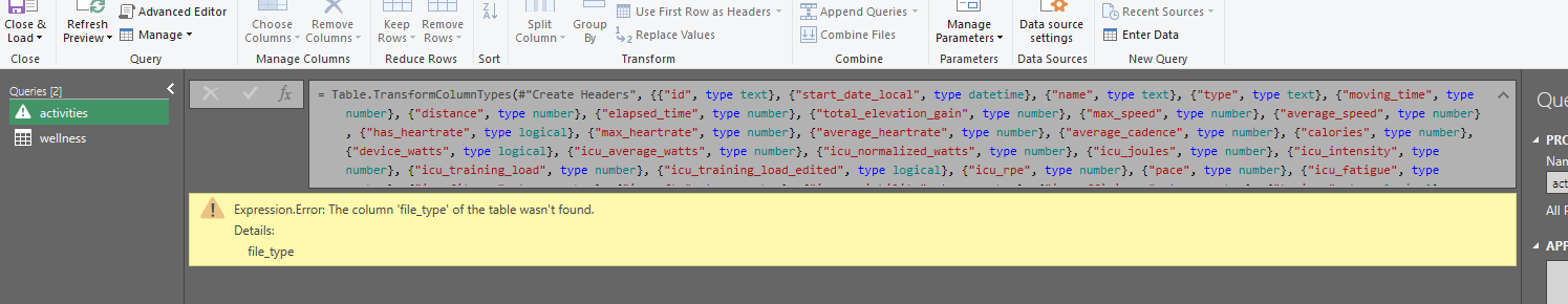

I’ve been out of action for a while and only getting around now to looking at this app / excel sheet again. My activities are not downloading. I’m getting an error message -
Expression.Error: The column ‘file_type’ of the table wasn’t found.
Does anybody know how I can fix this? Thanks
I think you just need to remove the Columns parameter from the query
Bingo! That worked a charm. Thank you very much
After removing the column parameter, you should notice a lot more extra info (columns) pull through.
