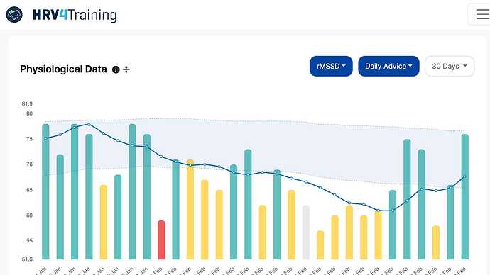

HRV, on the other hand, has already proved to be a great metric to follow regarding stress and recovery. Morning HRV together with resting HR and subjective feeling scores can give you some very meaningful information to adapt your training strategy.
This blog post and the subsequent linked articles, explain a lot and give you very good advice on how to use morning HRV.
