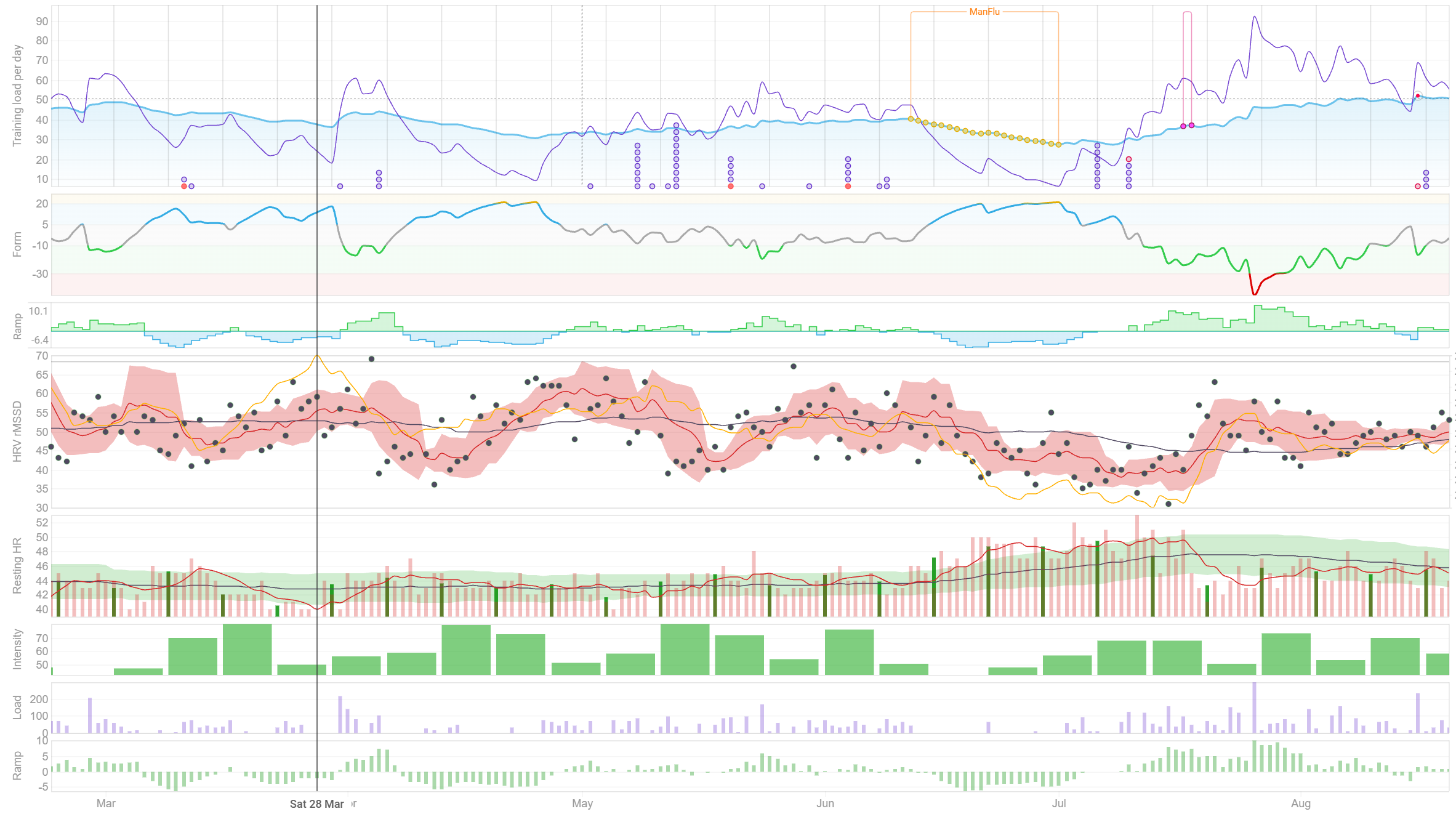

I really am having trouble seeing how HRV is any more insightfull than resting heart rate. As the resting heartrate goes up through sickness or over training the timing of each beat of the heart goes down (heartrate 100 - heartbeat 10ms ) (heartrate 50 - heartbeat 20ms) So unless HRV is normalised against heart rate a larg part of it is just the impact of a varying time per beat.
See graph below in th HRV graph I have added the millisecond per beat which except in rare cases just mirrors hrv.
I welcome your insights
