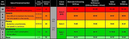

In short, you’re looking at information from different systems that will often not align nicely in graphs. Many factors will affect each system: muscular leg strength, cadence, hydration, metabolic efficiency, heat, etc… Also, HR is a lagging metric as opposed to power. This means that while changes in power will be recorded nearly instantaneously (depending on various settings), HR can take several minutes to reflect changes in output demands, both up and down. This could be why you’re seeing the Z3-Z7 buckets filled in your power chart but not in your HR chart.
One thing of note from your images, your HR zones may be set rather high. Regardless of what percentage base you are using, 80% as a cut-off for HR Z1 is very high. People often overestimate the top value of their zones. Most of the published zone values are for elites, not the rest of us. In the chart below, the highest value in each square is an estimate that equates to the fittest athletes in their particular sport. If you’re not an elite in the sport for which you are calculating values then your top-end value will probably not be the higher range value. (Note: HR values are calculated per sport. Your HR zones for one sport, i.e. cycling, are not the same as for another sport, i.e. running.
In the summary chart below, you have to find which values align with your cardio, pulmonary and metabolic systems. Once you do, then you have to keep an eye on daily, weekly and monthly fluctuations between power and HR.
I’ve posted a link to this chart in spreadsheet form in this thread.

Regarding the HR zones, I don’t put much stock in default settings. Check out the spreadsheet I linked to. Plug in your max and resting HR, note the various ranges and then keep an eye on how your body responds so that you discover your own HR zones for your body. The top of your HR Z1 might be 131 if you’re a young buck. Is your max HR for cycling actually 180bpm?
Personally, Sleamaker and Browning’s zones are spot on for me, no tweaking needed… I have an endurance diesel engine. Once warmed up (after 45 minutes) just keep feeding and watering me and leave me to it. I’ll go all day. Just don’t ask me to do a crit 'cause I’ll spew all over the course. (Tho that’s changing as I train for the Cykelvasa MTB.)
My favourite method for establishing power and HR zones is to sit on a trainer for three hours at least once a week. Take blood glucose (direct, not CGM) and lactate before starting out and then every 15-30 minutes. Use the first 30 minutes as easy warmup. During this time, the blood lactate should drop below the starting value as the body uses it for fuel. After that, you want to find a steady lactate value. If it starts to rise more than a little bit then you’re probably going too hard, back off and see what happens. During this time, be aware of respiration rate and heart rate. Notice as well your power output. Is everything staying steady? Keep track of water and food intake, as well as cooling fans. This is a great way to find out what your body can utilise. I learned both what kind of food and the amounts my body needs, and when that shifts to different needs. (After nine hours my body will NOT absorb any more simple CHO, period.) Once you can do this for three hours then start pushing the duration and see when your body starts to crack. If you can go five hours without lactate or HR drift then either go longer or bump the effort and see how things change.
One of the reasons I like to test this way is because it anchors mathematical values to biological systems. It’s all about energy systems.

I’ve downloaded the spreadsheet and input the values. My max HR is correct at 180 (confirmed at numerous races this season), and the spreadsheet fairly closely matches the values above. That puts the top of Z1 at 135bpm in the Sleamaker and Browning column.
I’m a diesel as well these days, and anything below 135bpm I can do all day even though I’m not so young any more. Z2 under that model is 136-144 which is perfectly achievable for many hours (recent races I’ve averaged 155bpm for 3hrs+) but requires much more intense focus and effort than simply spinning along <135BPM - and I’ll be well into Z3 power to do that. Recovery will be minimally longer, but I won’t generally notice much effect from even a 3hr ride at that level the next day.
