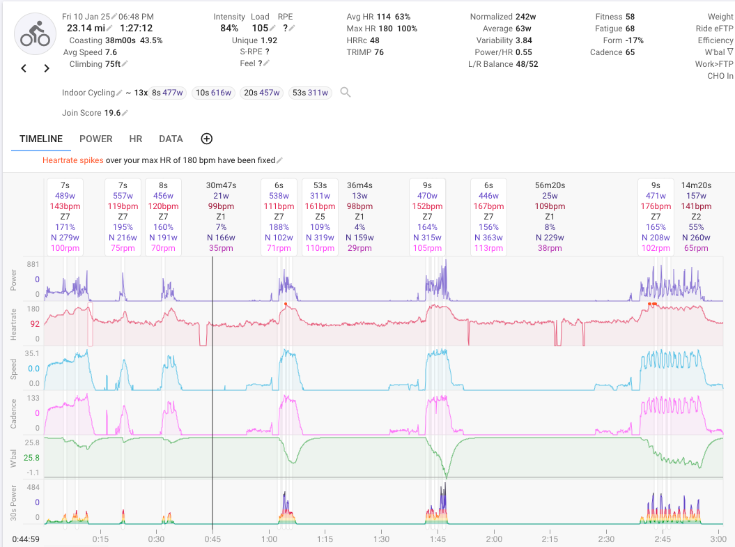

A bit late to this thread, but I find Intervals does a pretty good job with my track race data by default. I record on a Garmin with the GPS turned off, but with a wheel speed sensor. I think intervals automatically crops out sections of the ride with zero speed. A typical race night is 3-3.5 hours long, but Intervals normally says the ride duration is ~1.5 hours and the TSS looks reasonable for that (say 100-130).
Here is an example:
I have noticed that if I mess up the position of my speed sensor when changing a wheel and it doesn’t record speed data, then the ride stats get messed up.
