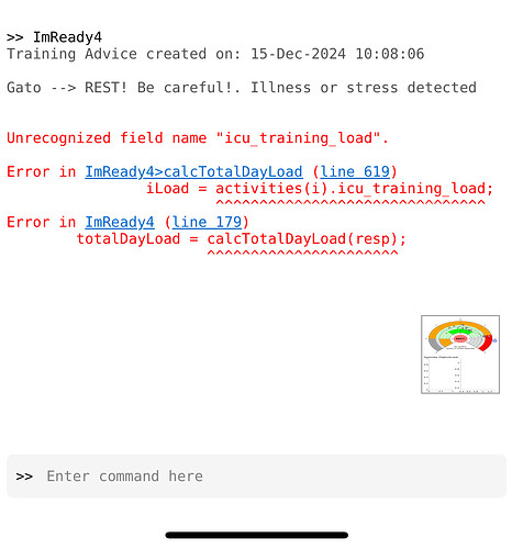

But today it happened again.
Pls @Inigo_Tolosa , any idea?
Tks
+1

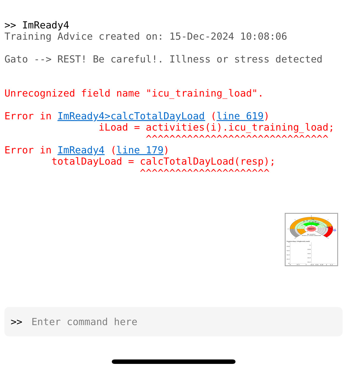

Since yesterday mine its showing the same error
Are you both using Strava activities?
It might have to do with the API limitations imposed by Strava?
Bit of a guess at this moment, but the answer may lead to a diagnosis…
Garmin activities in my case.
I started a new season in intervals, dont know if its related.
It worked fine until yesterday.
Strava too. you might have a point but I could not find the rational.

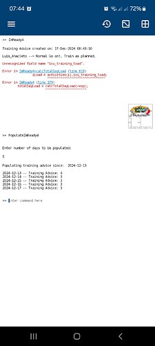

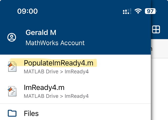

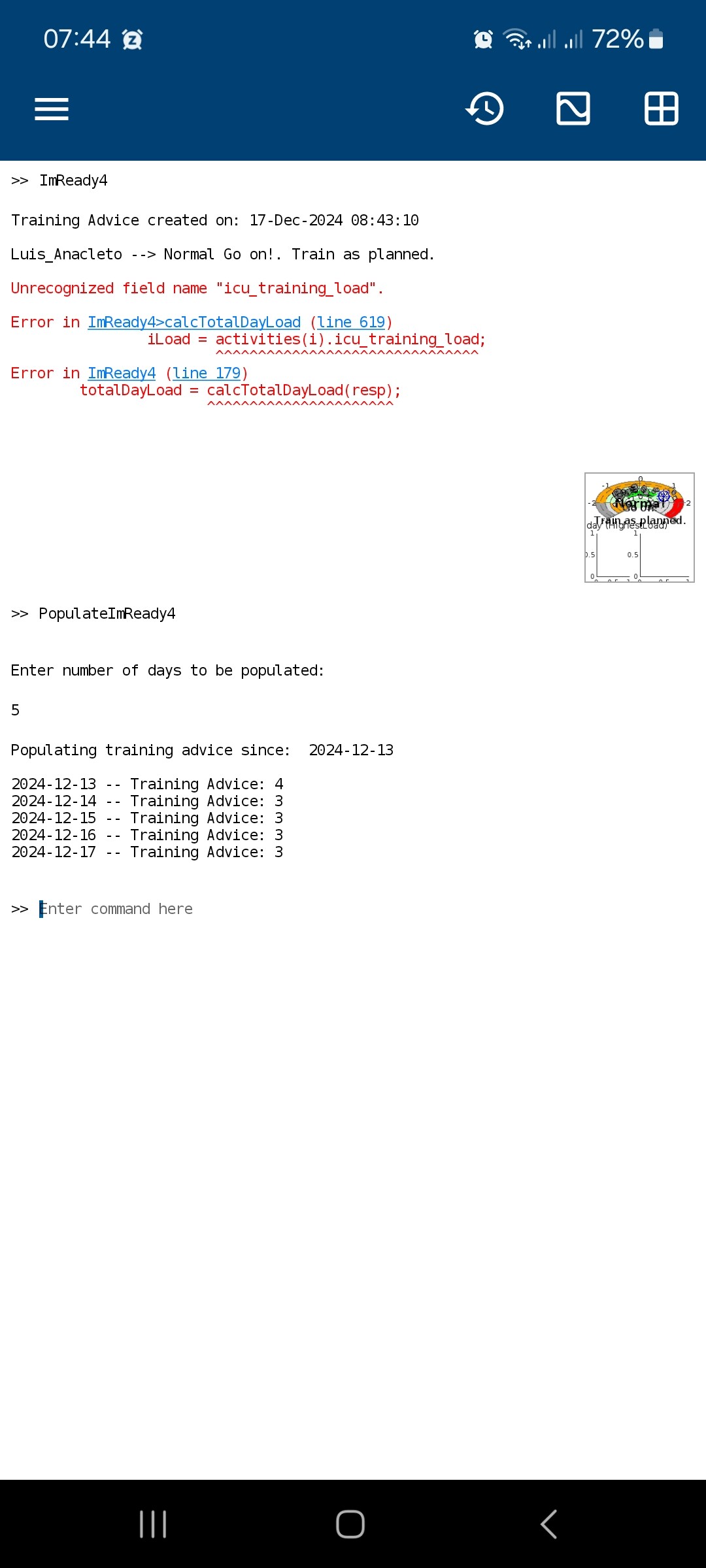

What happens if you use the PopulateImReady4.m script?
Choose the number of days you wish to update, eg. 5 = Friday to today.
IMG_7336
Ok, but does it work now that you’ve populated all the days? Do you still get the error? I suppose it fails because there are some empty days, so it cannot calculate the load.
It shows that all five days have a training advice value, but the load chart is not working. It was showing the training advice in the ImRaady4.m script.
So the error isn’t affecting (or shouldn’t affect) returning the score to Intervals; it’s just the load chart (bottom left) that is not showing up.
I never had problems with empty days.

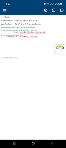

To me it looks like the app is able to get wellness data because the Training Advice is populating. But it looks like in some cases the activity for the previous day can’t be read.
IMREADY4 queries for the activities on the previous day and uses the one. with the highest load
It can also use “last load”.

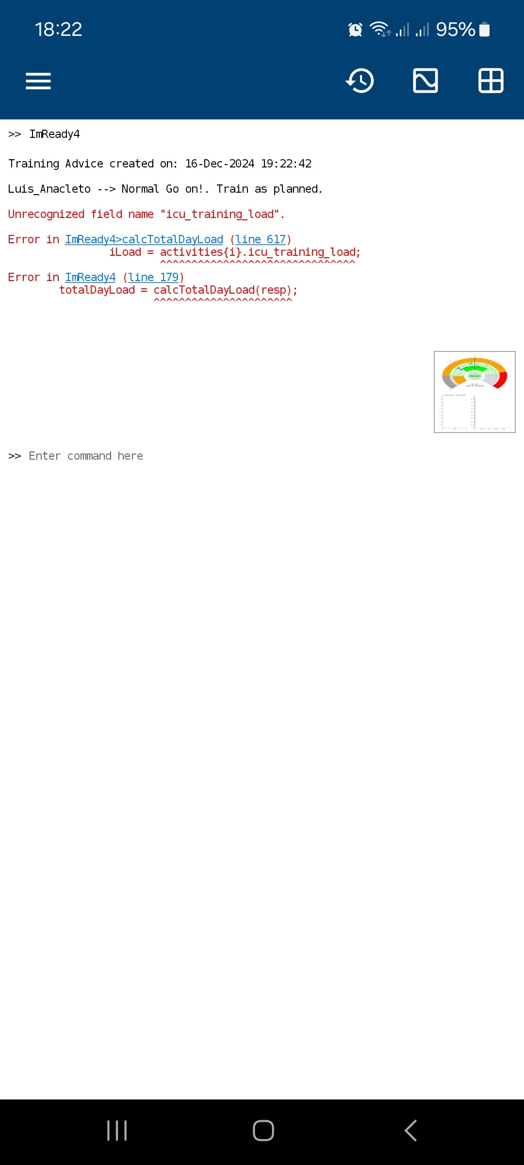

Still get the error.
Tried last, highest and longest, all give the same error.
Didnt change anything and from a day to another this hapens.
I will keep trying to fix
It’s been some time since I have maintained this code. I will take a look at it in the coming days
By the way, @LUIS_ANACLETO @Gato_Felix , can you check if there is any activity without load information for those days when the error happens?

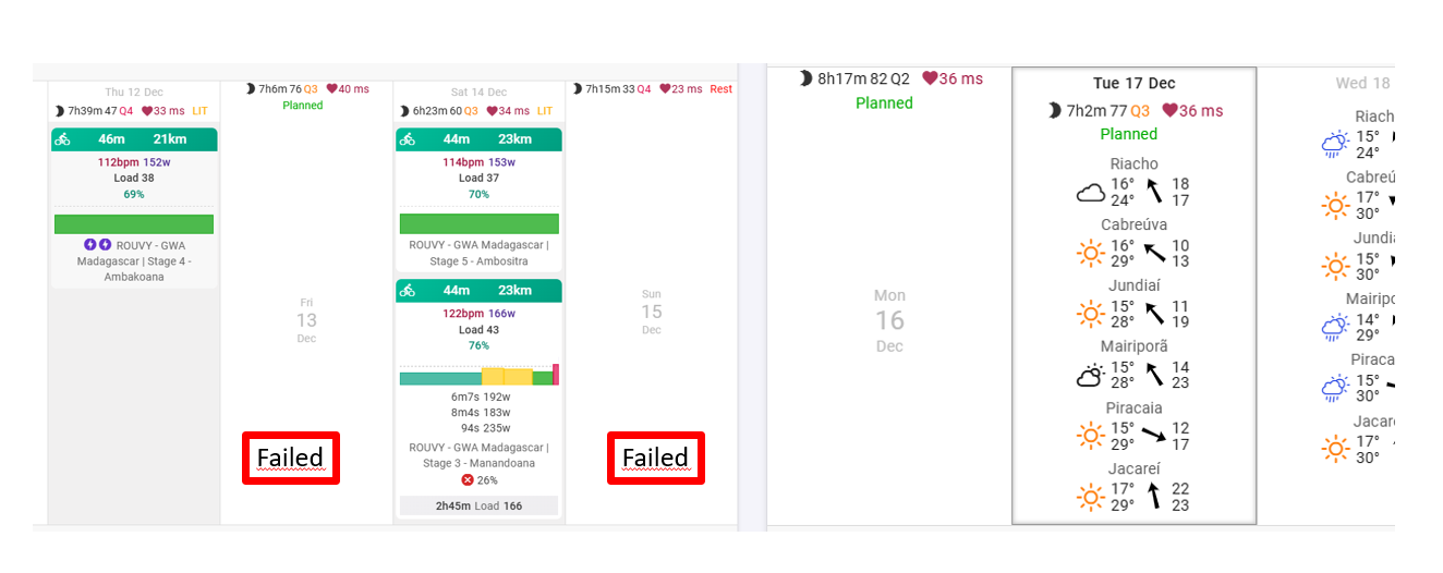

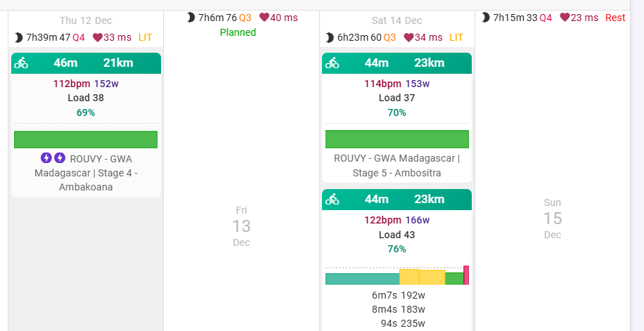

@Inigo_Tolosa and all.
First of all I wanna apologize I made a mistake on my previous post.
The correct is that the second failed occurred on Dec 15th a day with load.
So it appears it failing after days with loads.
The chart bellow shows better.
Are there people synchronizing with Strava and having not problems?
Tks,
PS: the only reason I thing with strava is because the “Update Strava name and description” feature but if Strava to be the problem I can leave without it.
Strava is not the problem because @LUIS_ANACLETO has the same thing with direct Garmin activities.
