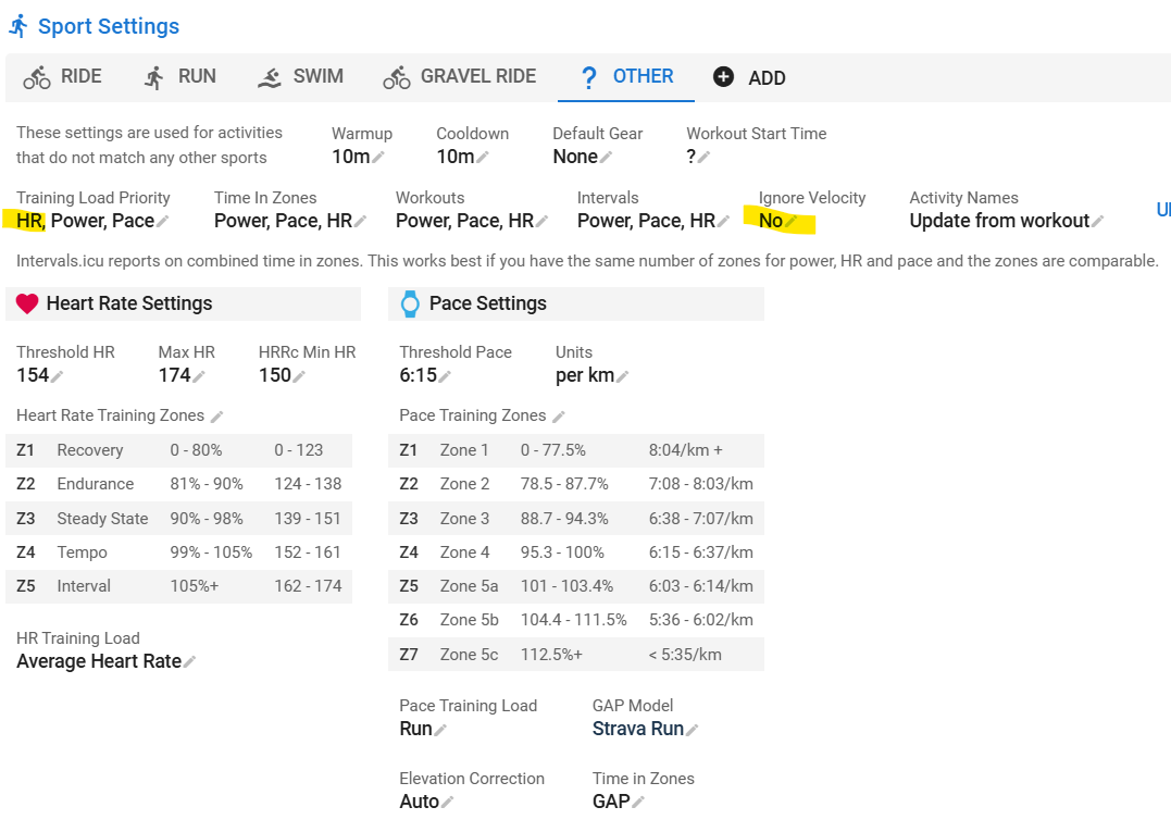

In the category that will be used there are, for what I see now, two important settings:
  • Use HR as primary load metric
  • Set Ignore velocity to Yes, to make sure that all time is considered ‘moving time’ and that all HR measurement will be counted as active, and creates Load. I suppose you already deactivate GPS on your watch profile? If not, the entrance of a cave will have some erratic speed measurements.
And off course, make sure to set a plausible LTHR

As i tried to explain., Intervals counts Load for moving time when a distance/speed stream is available. If that stream is erratic, Load is not correct. In that case you need to ignore the speed and count all time as active.
