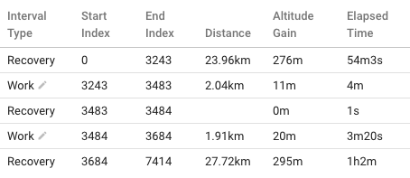

You need to do this on the “Interval data” page rather than dragging the edges. You need to keep a 1s recovery interval between each work interval. Click the work intervals and edit the start and/or end indexes:
Screen Shot 2020-11-18 at 20.46.56
Thanks. I’ll try that. I think I was using my phone and couldn’t find the “interval data” page.
Why the 1s gap between intervals?
Thats a limitation of the intervals edit functionality. If two intervals are exactly next to each other it will combine them. Its something I can fix in future,

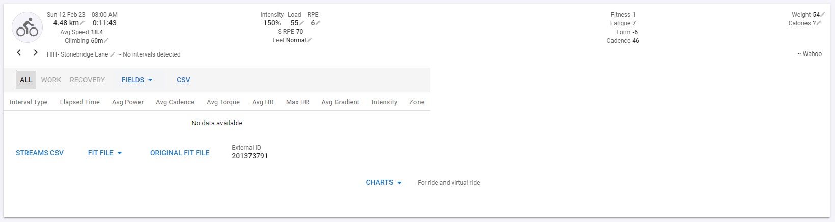

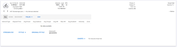

If it doesn’t, post a screenshot with the traces you have and also a screenshot of the Activity Intervals page.

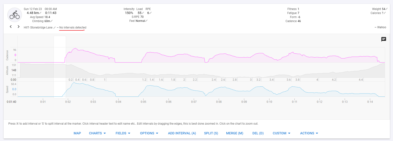

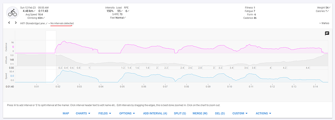

Yes, I only had a speed/cadence sensor and GPS.
I see the vertical line but when I press A, I see a white box flash that soon disappears and “~ No intervals detected” appears on the top. Here are the screenshots-
