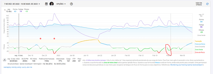

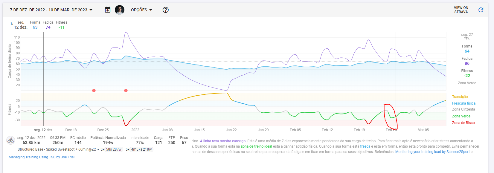

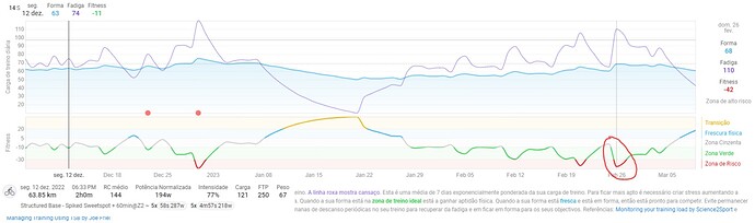

Now for the second doubt, below are two images of Fitness, Fatigue, Form graph from yesterday and today, and somehow, the ride I did yesterday was giving way more fatigue yesterday than it is giving today, even though the TSS didn’t change (244TSS).
Can it be related with the information not coming from strava anymore? I moved to garmin + dropbox, but I just unthicked the option of getting activities from strava instead of deleting the connection. (and I dowloaded all the activities before).
Nevertheless, in 12th December, my Form, Fatigue and Fitness were the same so if this was due to any activity shenanigans, these values should have changed as well right?
What might be the reason of this?

To answer your question on the graph changing between “yesterday” and “today”. Fatigue is the weighted moving average for 7 days, so look at the total load over the last 10 days and compare the total for days 1-7 for each day. You will see a big load on your last activity compared to the previous day. The purple line indicates a big jump.
I understand that, but what I’m referring to is that the same activity, had a bigger jump (in purple line) yesterday than it has today, even though the TSS for said activity didn’t change.
Strava will automatically be hidden if there is a duplicate activity from Garmin. It should remain hidden unless you added Garmin (refreshed data) after clearing the Strava data.
I think you have a duplicate activity in the second screenshot.
That might actually be the case. It makes sense, and it explains why it changed from yesterday to today as I was changing some settings to the data sources for Intervals.
