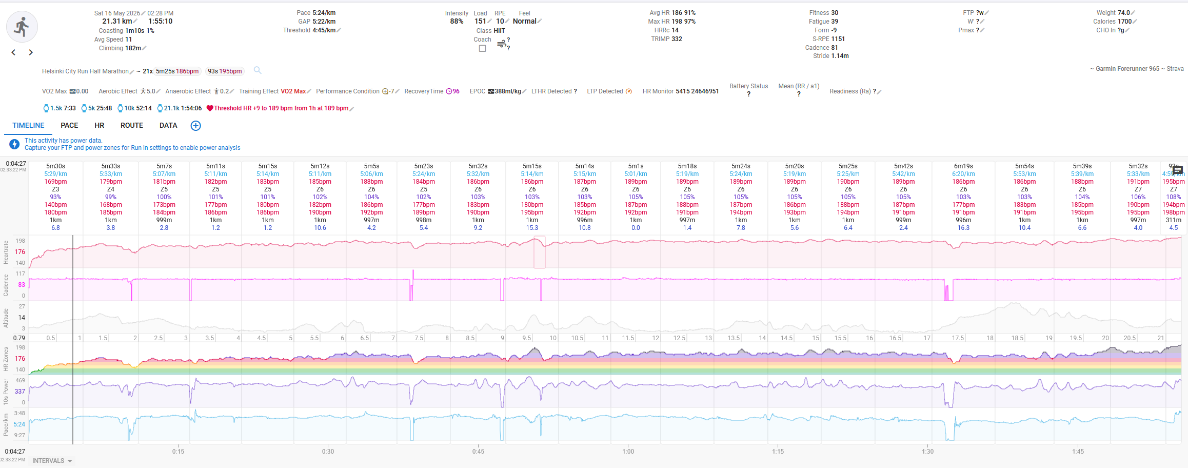

Here are some examples, can you see these races or do I have to change some setting?
Intervals.icu Same race in 2022, avg HR was 191
Intervals.icu Same race in 2024, avg HR was 183
Intervals.icu HM in 2024, my PB, avg HR was 178
And yesterdays race, Intervals.icu, avg HR was 186
