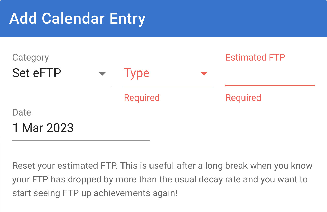

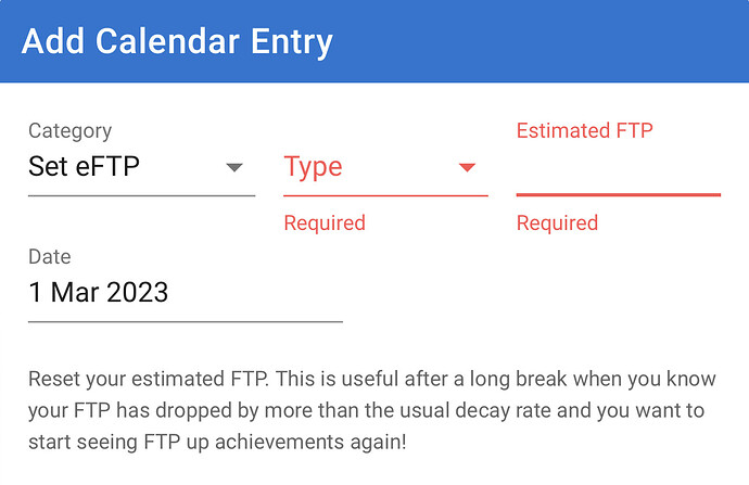

Is there any way to “restrict” (optionally) the calculation of eFTP just for my actual season to reflect better my current FTP? I did a ramp test some weeks ago and intervals gave to me a very close estimate FTP for that ride… but it is lower than model so was not used… :frowning:

I think I have just found a possible solution?
:laughing:
P.D: I am still curious about how many days question for eFTP?

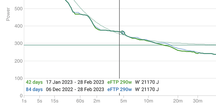

You have found the solution. The “running” eFTP number doesn’t have a specific number of days of input. It goes up when you set a new higher number on a ride and gradually decays if you reduce training load. You can get an eFTP number for a specific time period on the /power page. Look at the bottom of the chart.

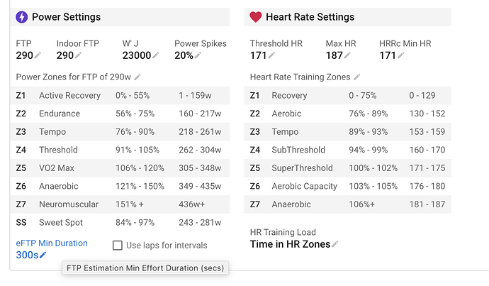

If you are finding that eFTP too high you might want to adjust the minimum max effort time period in /settings:
