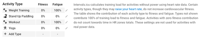

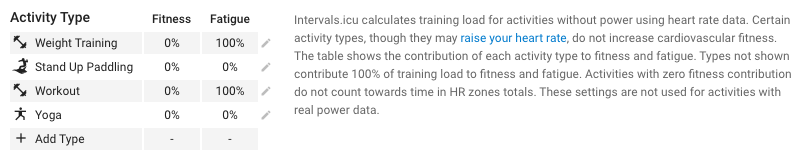

Also you can configure how much of the training load is applied to fitness and fatigue for different sports. Some activities like weight training raise your HR but don’t help cardio fitness.

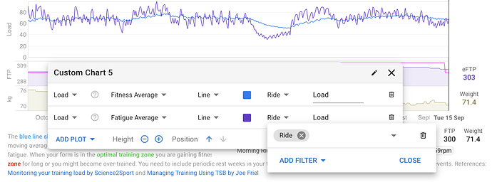

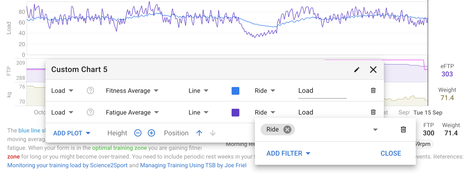

Tx. You can do that to a certain extent with custom charts on the /fitness page. Here is a fitness and fatigue chart only for rides:
Click “Options” -> “Add Chart” -> “Custom” on the /fitness page to create custom charts.
