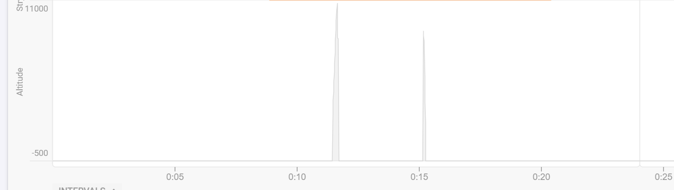

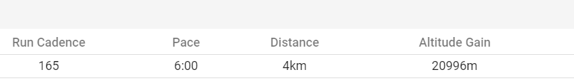

Hi guys, my watch has recently been playing up with its altimeter. I have logged a ticket with Garmin to see if they can fix it. Anyway I was wondering if there is any option with this feature in intervals where I can select the runs since my watch has stopped working and giving bogus elevation and just use GPS data instead for those select activities? I don’t want to update the watch type as it should have accurate elevation if it was working properly (Garmin 255). Cheers
Check ´Elevation Correction´ and keep device setting as is.
Once your watch is repaired, uncheck it again.
Hmm, I have tried above, and also reprocessing after doing that, and also re-downloading from Garmin but in the altitude graphs it still doesn’t update to reflect
I was expecting this to be corrected based on GPS, am I missing any other step? Thanks

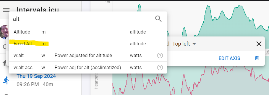

For the plot, I think you need to add Fixed Alt
The Elevation Gain field should already be good if I’m not mistaking.
That’s its, thanks for your help.
