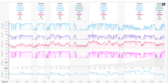

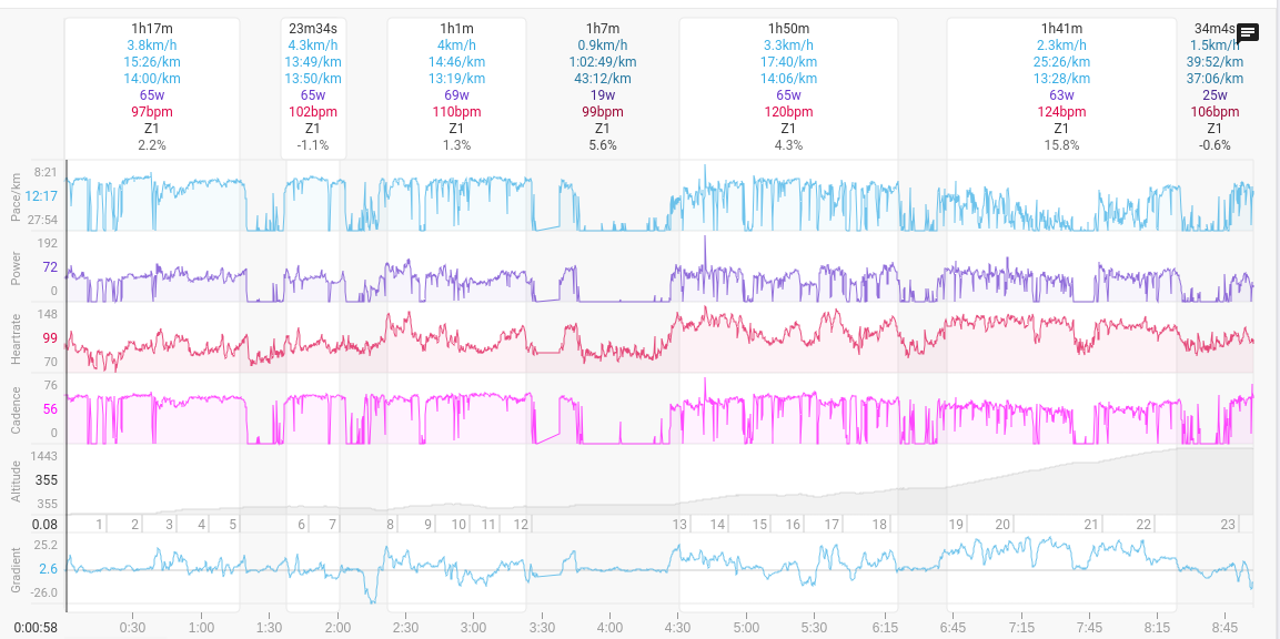

The full activity looks like this:
No Power Outages or anything. Power always correlates nicely with pace.
Also, towards the end of the activity, where the gradient gets higher and my pace slower,
the power stays pretty constant.

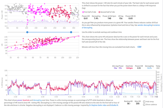

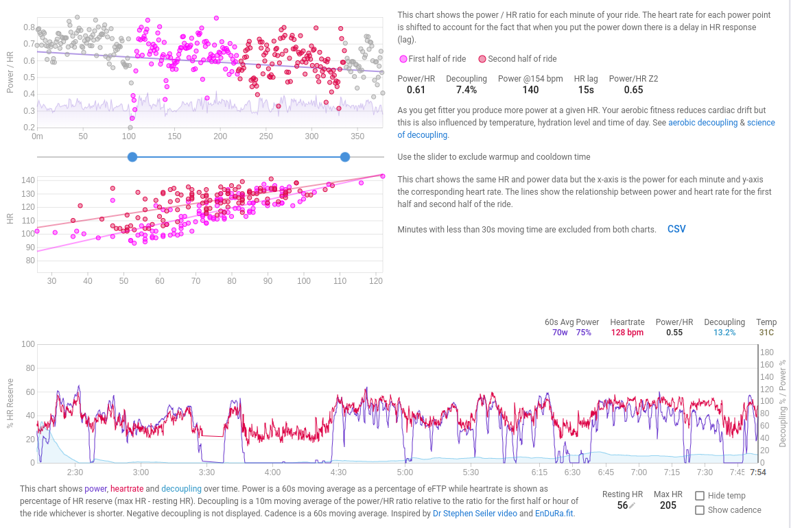

Also the Power – Heart-Rate decoupling seems to be working fine.
