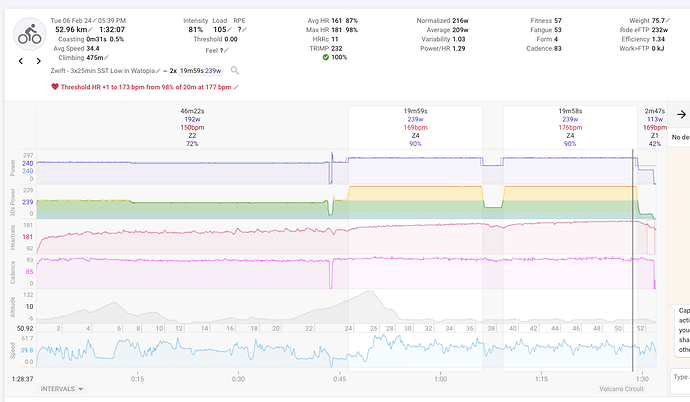

Hi guys I wanted to share some more data, although I did miss calculate my tempo range, I was only outside of it by 4 watts (FTP is 265W). I performed the tempo at 240W for 20 mins (x2). The highest HR I have ever seen is 182 BPM.
Here is a screenshot of my workout where I get the high HR.

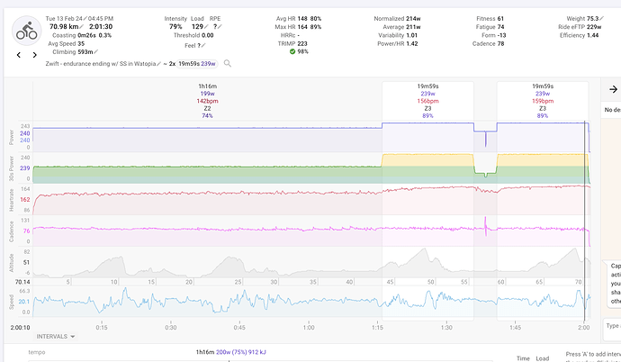

I then complete the exact same workout a week later, and the highest HR I get is 162 BPM.
Looking back, I think it was due to poor nutrition and hydration. Thanks again.
