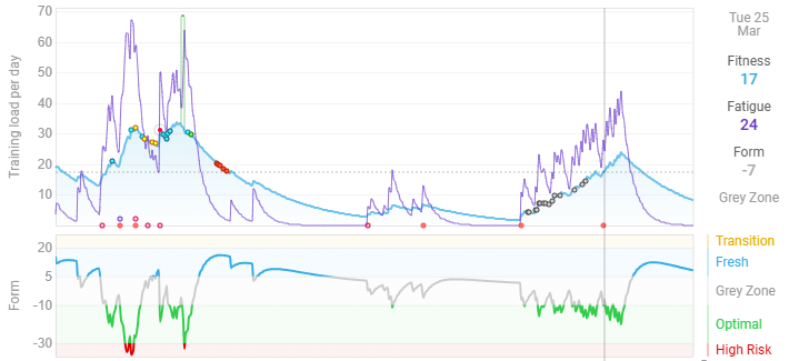

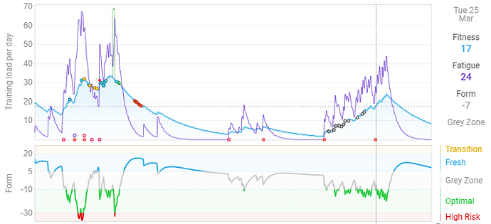

If you put your workouts on your calendar, you see the progress of your future fitness in the fitness chart (set the end date to a date in the future).
You see the weekly fitness values in the plan builder too.
Yes, as R2Tom said above, plug 'em all in, and view via your fitness chart, pic here.

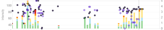

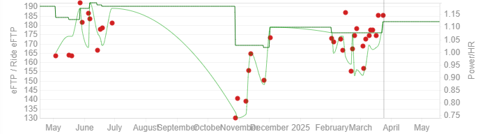

You can also setup any custom charts you want, to snapshot & monitor the indices you find most valuable.
I have one I really love that shows Wkly Ttl TiZ as stacked bars, with RPE and Intensity % set overtop as dots. Snapshots pretty much all of what I like to keep an eye on, in one place.
I also run one showing eFTP and Ride eFTP, w HR / Power as dots overtop, love that one too.
