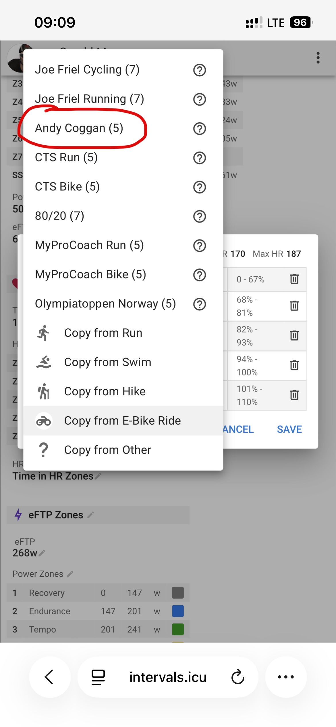

Only based on my feeling, it seems that Olympiatoppen Norway (5) model is the one which seems the clothest with my feeling. But with the model the Zone 2 is 81% - 91% (max HR), which is super hight compare to other model !!

Coggan zones are for cyclists, so I should’ve made that clear in my reply. As a cyclist, my experience is mostly on two wheels and not two feet.

Ho ! If coggan zones are for cyclists then it makes more sense. but then it also depend if you set your max HR for cycing activity or you overall max HR.

The zone numbers in Coggan and Olympiatoppen do not mean the same thing, so they cannot be matched directly. For example, Coggan Zone 2 is closer to Olympiatoppen I-Zone 1, Coggan Zone 3 is closer to I-Zone 2, and Coggan Zone 4 is closer to I-Zone 3.
Watch out here! OLT model has z2 as 81-91% of LTHR, not max HR! It’s actually 72-82% of max HR.

Ha yes you are right . I checked again and between Olympiatoppen Norway (5) and CTS run i have almost similar value. I also didn’t know coggan zones was for cyclists . Maybe it’s something that could be added (something like : Andy coggan bike(5) )
