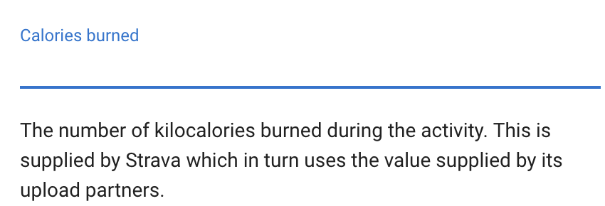

Something I noticed with the new Karoo integration is that if you’re also syncing with Strava, the activity calories (kcal) are no longer populated.
So it seems that neither the Strava kcal nor the Hammerhead kcal get pulled into intervals.
I can confirm this is true for me as well. I sync from Hammerhead, Strava and Suunto (although it appears that the HH sync has superceded the Suunto data - it is no longer shown as a data source for my activities).
Both Strava and the HH web pages show (slightly different) calories for my activities but neither value appears on Intervals. I can see this on my latest activity from this morning, while activities fed solely from Strava do have kcal data.

I have checked the file from my Karoo and see the kcal field defined at the top of the file but do not see any values in the session section at the bottom, which implies that is calculated on the receiving sites by both HH and Strava.
There is a note on the kcal field here on my latest activity that says:
That seems to imply that Strava will be the preferred source.

if you have Strava + others, others is always the preferred.
Intervals.icu will pull the total_calories field from the session message of fit files. I had a look at a couple of yours from Hammerhead and that isn’t present. Also fitfileviewer.com complained about various problems with the file, not sure what’s up with that.
I am not sure where Strava is getting the data from. Maybe it is calculating it from the power data?
Thanks David - I’ll do some checking with Hammerhead since I didn’t see it in the FIT file either. They display total calories on their web portal as well so it may be that they are calculating it from the power data. RE: the FIT file, I received an error message from Fitfileviewer too but FIT file viewer – RUNALYZE handled it without issues.
