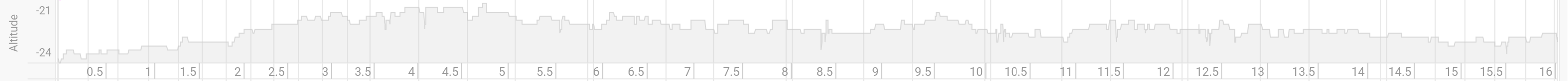

ERG. The altitude track very much is a “wobble” of a meter here and there probably due to atmospheric pressure change, e.g.
Ah, you are training in your basement under sea-level :joy:
Just joking :wink: . My Garmin isn’t recording an elevation stream when GPS is off. Hammerhead seems to behave differently, which is not necessarily wrong. Indoor training at high elevation could be accounted for this way.
It could be, but my under the sea basement is a conservatory at approx 50 meters above the sea, so it’s incorrect even if I wanted to account for it. It’s not even particularly consistent as in other static workouts it puts my static bike setup at anywhere between -100 :chart_with_downwards_trend: to 160 :chart_with_upwards_trend: meters altitude.
Looking out the window suggests to me that where I live does not move 260 meters up and down. Something is fishy, but it’s not me. :fish: Hammerhead have struggled to get this right, if I follow some other online discourse https://www.reddit.com/r/Karoo/comments/162ubgx/status_false_elevation_data/
