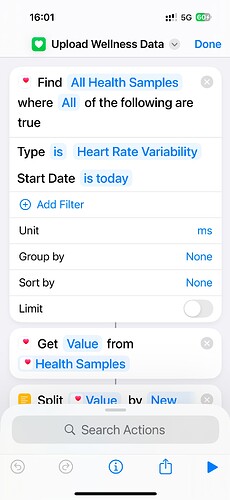

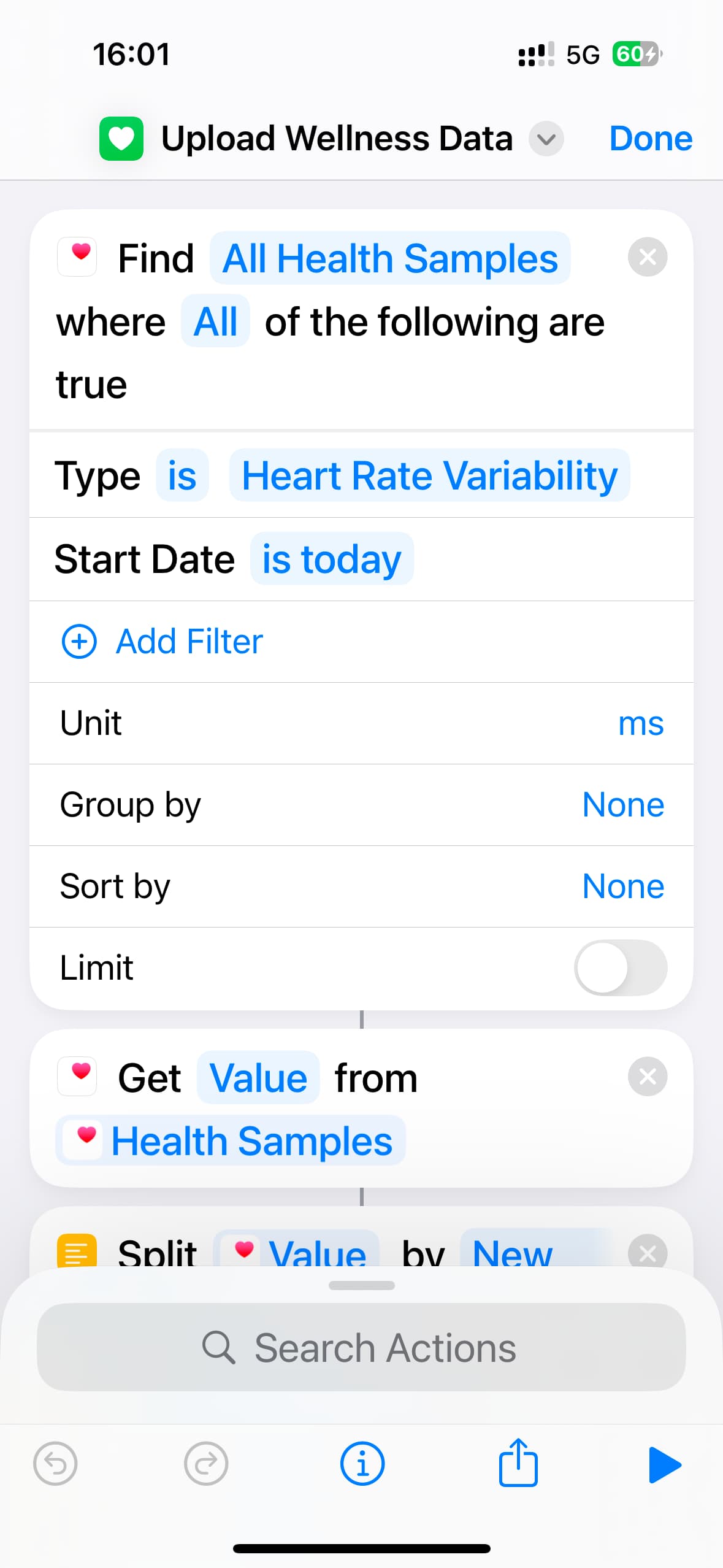

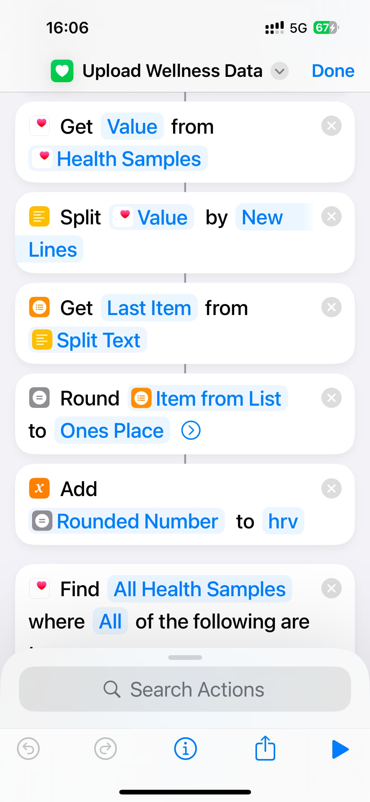

In the Shortcuts, you can create a Find Health Samples to get the data you want, and modify that data a little bit to the intervals.icu platform through API.

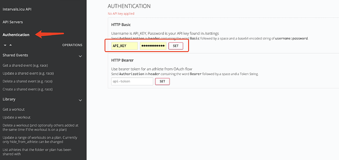

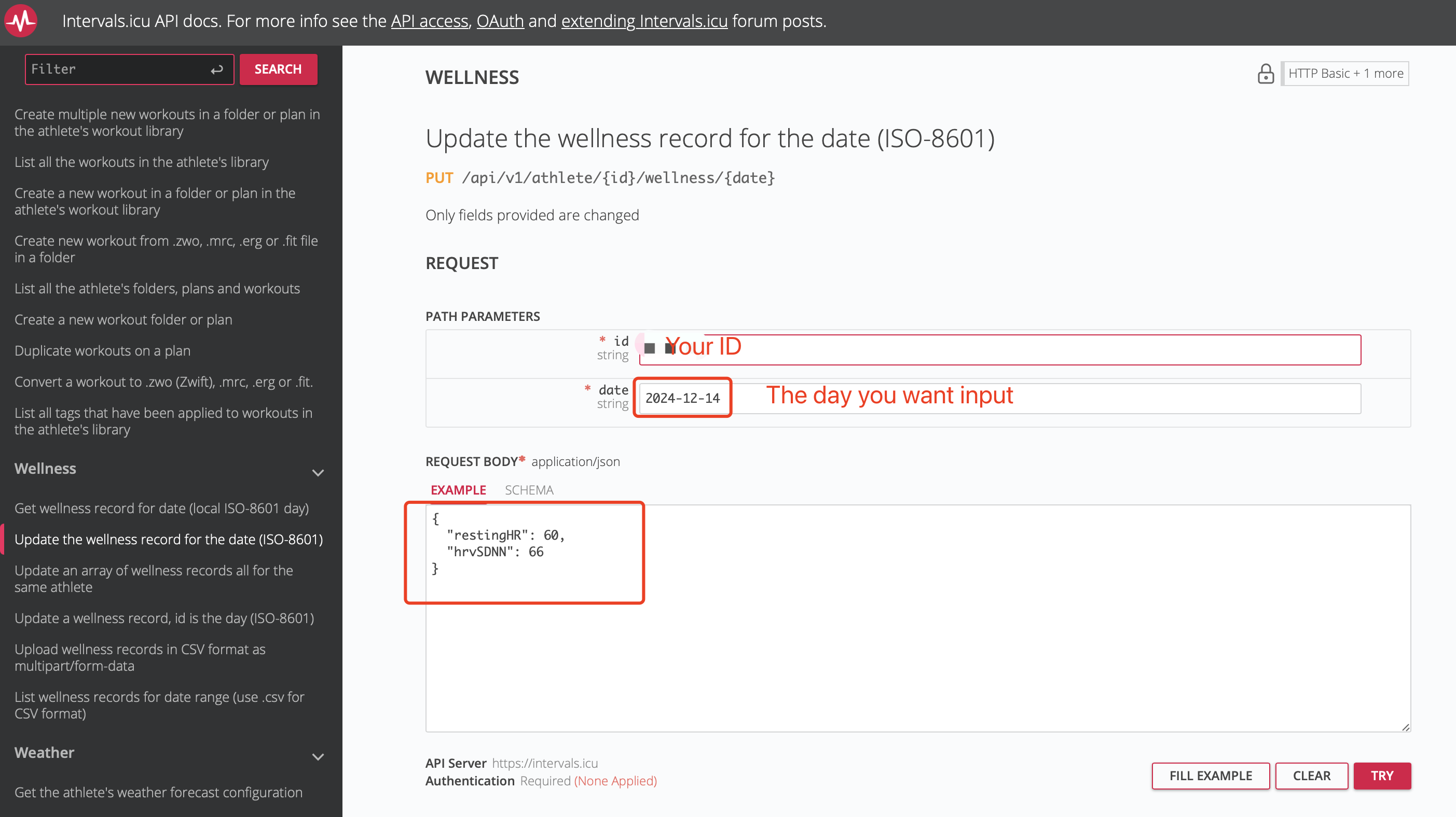

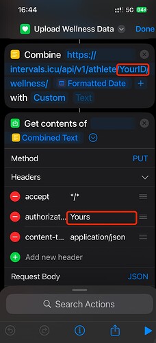

The following steps show how to put the data to the intervals.icu. This is most important part. Firstly, you need to have your athlete ID and API password (where you can find in the Settings- Developer Settings), and then go to the intervals.icu Wellness Endpoint to get your personal Curl data.

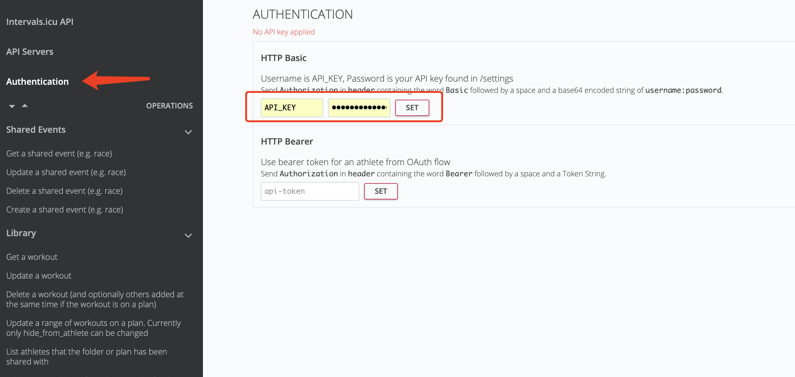

Firstly, go to AUTHENTICATION to set your personal API data

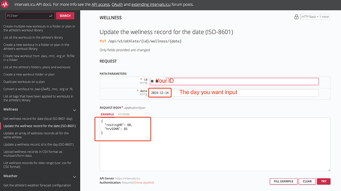

And then back to the Wellness section, input all the info and try. I’m using the restingHR and HRV data as an example here.

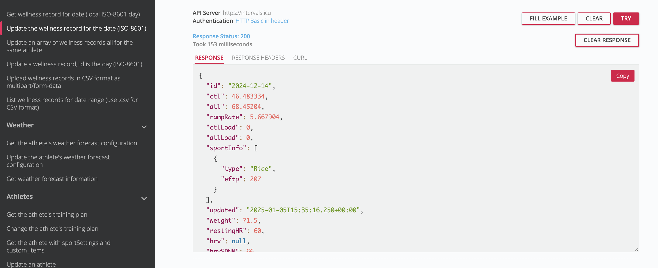

Once you have input all the correct data, the response should give you the right answer, where it shows the related data you’ve put, and you can also see your data changes in the interval.icu Activities.

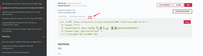

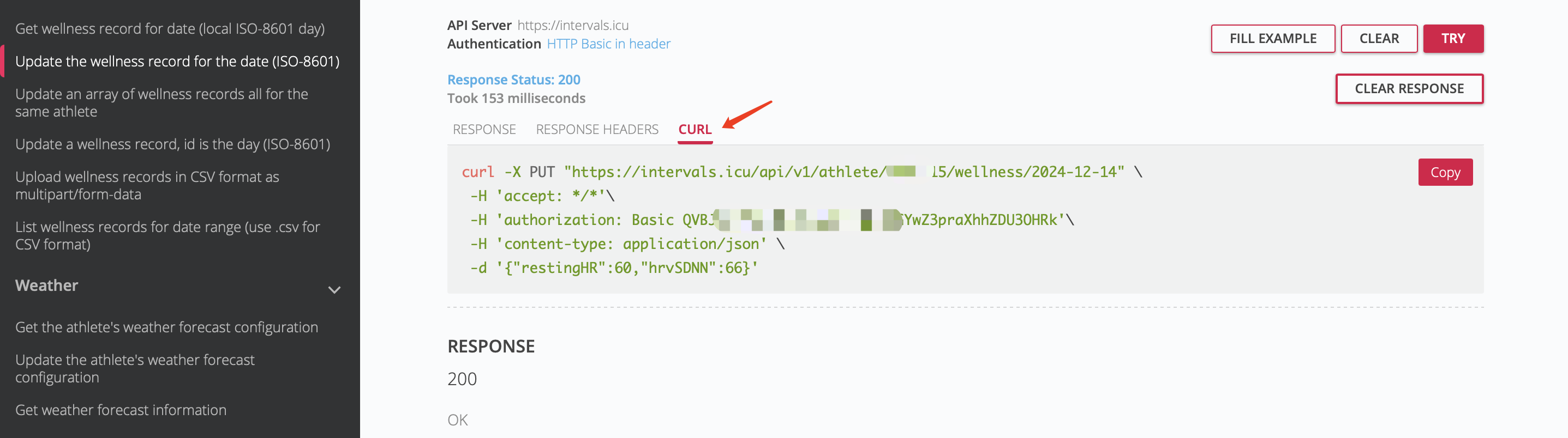

And then the last step, go to the last one CURL, here we have all the info that we need in the apple Shortcuts.

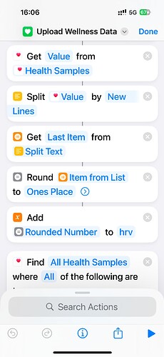

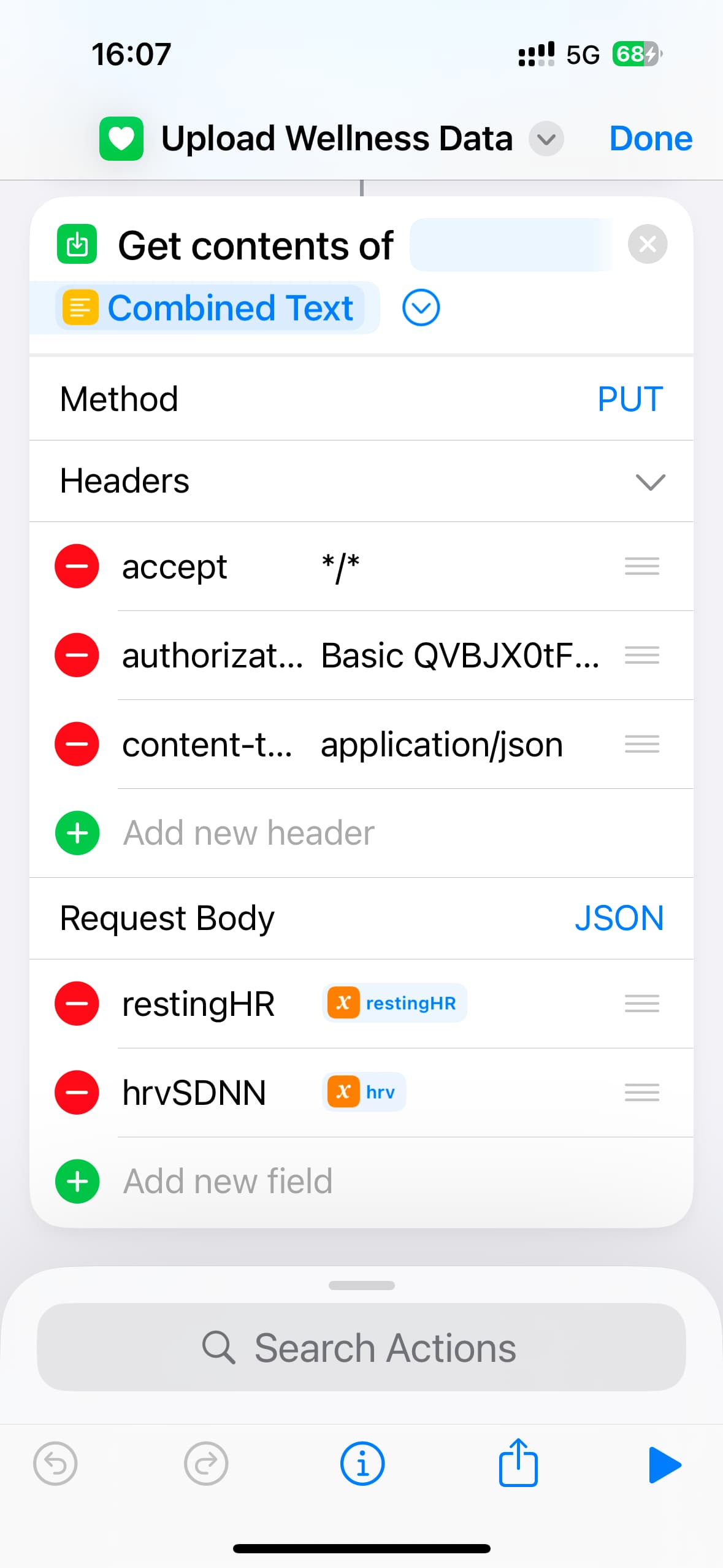

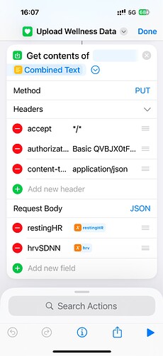

In the Apple Shortcuts, you can input the data via Get Content of URL command like I post here
the request Body is the exact data you want to put to your interval.icu, and here are all the wellness data you can put:

Finally, I’m posting my Shortcuts below for your reference, and please make sure to change the marked parts to yours info.
Technically, once you set up all stuff and put the data you want successfully, and it is possible to upload data automatically without any touch and notification through Automation in Shortcuts. But just technically, because I need to open Apple Health App the first time every day after I set up, still working on that issues, but anyway I can have the data now :slight_smile:

Here’s the shortcut I wrote:
https://www.icloud.com/shortcuts/68d796ffedb740f7a7949b2f21787a2c
I do a 1-minute meditation with Apple Meditation on my watch first thing after waking, and then immediately run the shortcut from my watch.
The shortcut picks up the latest values that Meditation wrote to Health, saves them in notes, and then sends them to Intervals.

Amazing job. Maybe I am doing something wrong, but in the API interface, after setting my ID (starting with “i”) and my API key (which I regenerated on intervals settign page), I am unable to get or push data. I receive the message “Access denied.” I pretty sure I’m copy pasting the good data. Am I doing something wrong?
  "status": 403,
  "error": "Access denied"
For the API, the user is the literal string ´API_KEY´.
pw is your api-key
Upsss :grimacing:
Now it’s working, but I have another issue. It seems something is wrong when retrieving HRV data from Apple Health and converting it into a rounded number. The resulting HRV value is an excessively large number (20 digits, with the 2 first being correct), which causes an error when trying to push it to the Intervals API.
The restHR and this large HRV value are correctly written in the HRV apple note.
