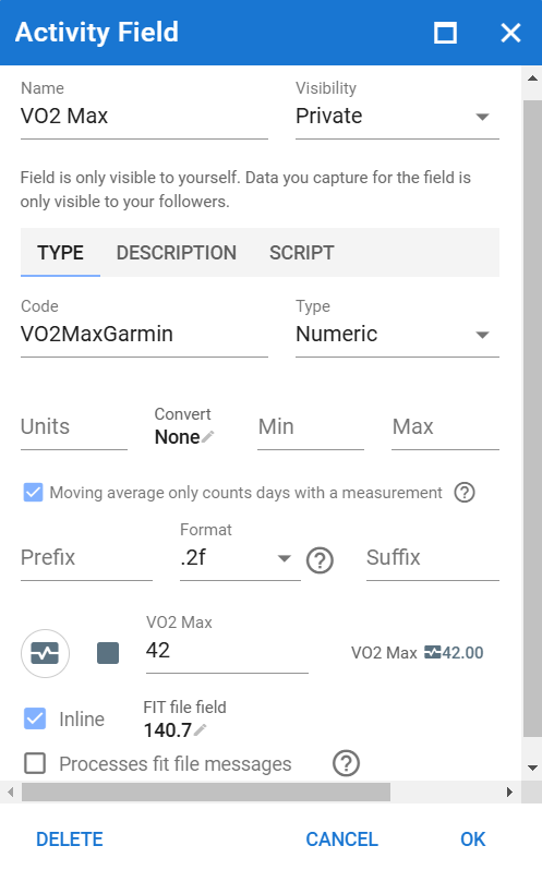

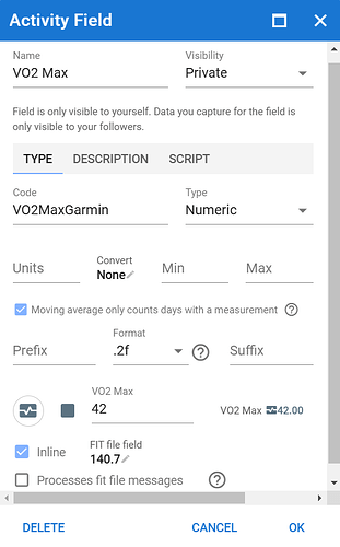

hi,
On a given activity, select “Custom”, “Add field”, and copy the values below:
and also copy that in the ‘Script’ tab:
activity.isNew ? activity.VO2MaxGarmin * 3.5 / 65536 : activity.VO2MaxGarmin
Then at the top of the activities fields, you have the VO2Max displayed:
You need to reprocess the Fit file.
x.
PS: I don’t know how Garmin estimates this value, but it seems pretty high. I am good but not that good unfortunately !
