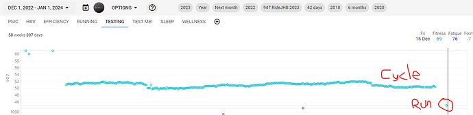

I have running and cycling on my GC Status/web, tho honestly i don’t look at it often but I did notice (with this thread) that looks like the values that’s coming to Intervals.icu is my running one…

I got a running VO2 transferred in yesterday. So that message is almost definitely the reason. Unless your option for a general VO2max goes away completely it will likely be the one the API provides and won’t switch to the cycling value.

It’s been pulling my cycling VO2 value for the last year, then all of a sudden nothing, from last week Tuesday. I uploaded a run, yesterday, from a few years ago, but changed the date on Fitfiletools to yesterday’s date just to check, and the running VO2 value pulled through. Today’s MTB ride hasn’t synced either, so there is a problem with my connection from Garmin to Intervals. The workouts push to Garmin, so there’s no problem there.
