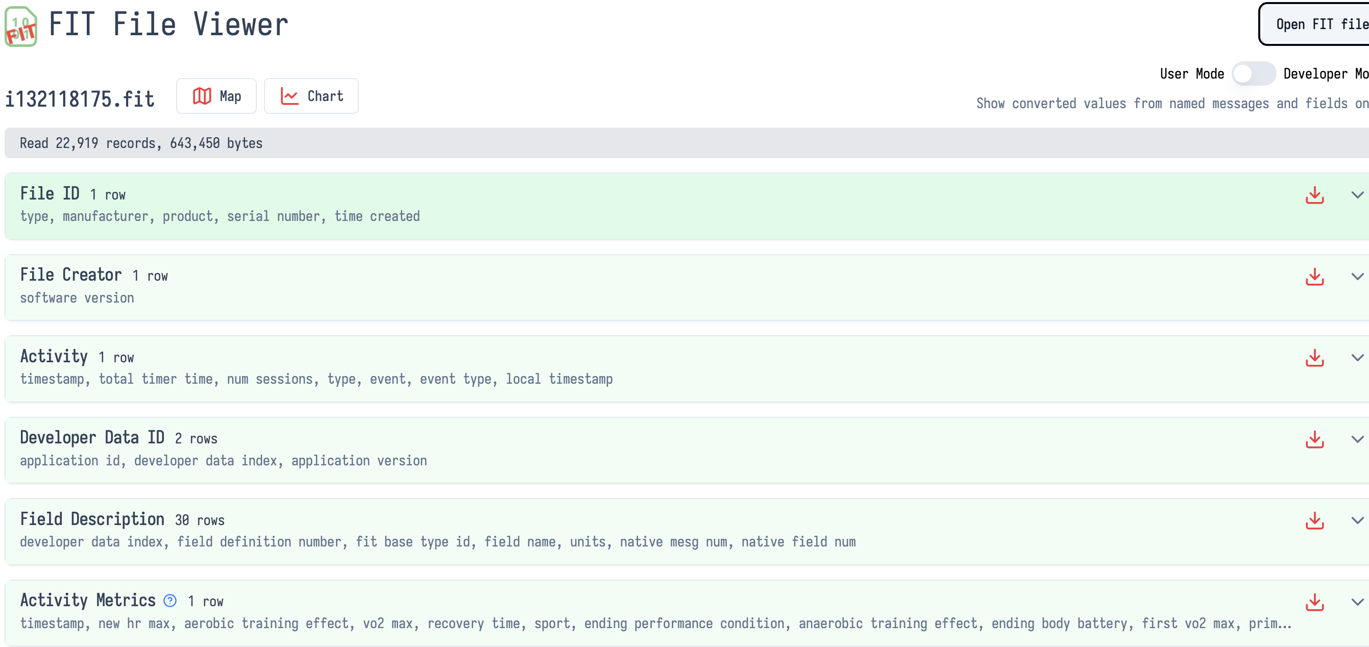

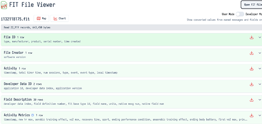

still there, for some reason
Fit file message number 79, 140 and 147 gone, and many message number 18,19 and 20 fields gone.

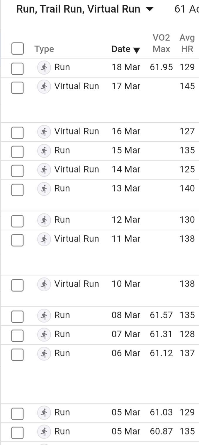

Not sure if anything changed in the Garmin API, but I just came back from a run and I see a VO2max value populated now :+1:
VO2 max can be present in the FIT file or sent via the API
Right, but I never download the fit files manually. I use automatic sync from Garmin to intervals.
Also, I had the same issue as reported above from March 10th to March 17th inclusive. No VO2max value for these dates. I run everyday, and today was the first day the VO2max value is back.
