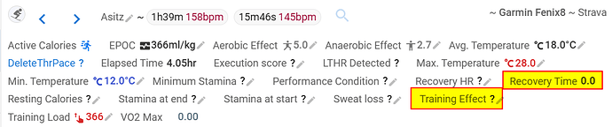

On my activities from this morning Garmin fields (from some custom fields by the community).
Performance Condition, Training Effect, VO2max all impacted. Aerobic and Anaerobic effect and Training Load all appear to be coming through fine though.

I am also having this issue in relation to some fields. I am missing at least: recovery time, performance condition, sweat loss and V02Max Estimate.

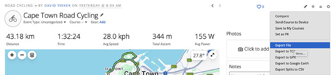

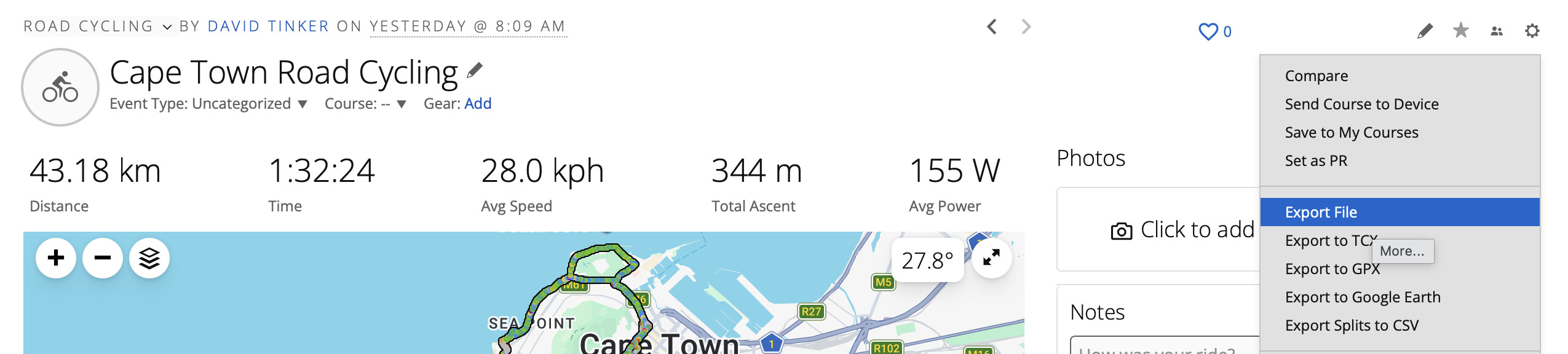

I also raised this with runalyze (Garmin Fit Details File - Runalyze) as I noticed the same issue. It seems that exporting the file from garmin and uploading fixes it. I believe they are investigating if Garmin has changed anything in their API.

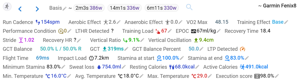

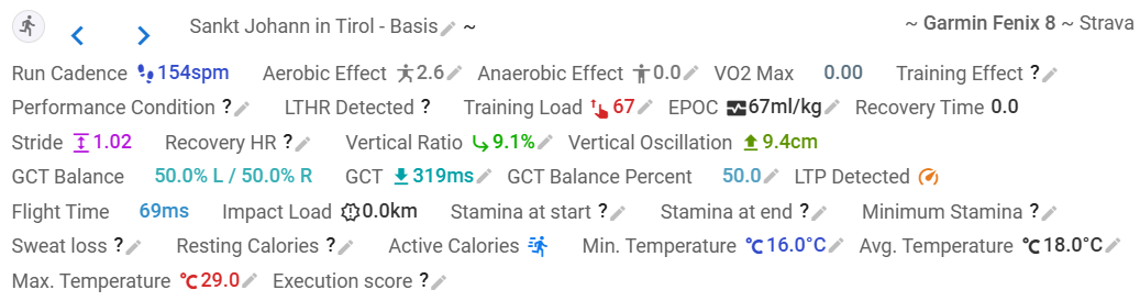

Auto-Import Garmin Connect:

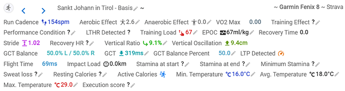

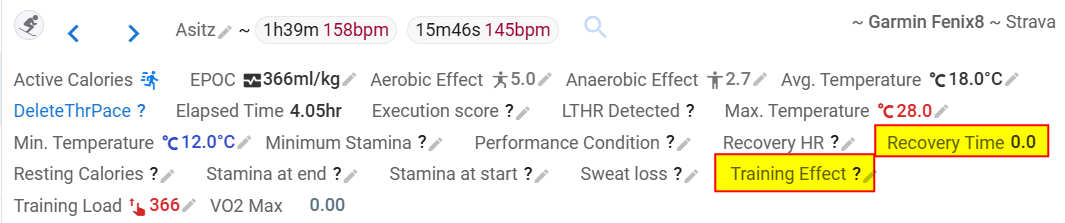

Manual Upload - Fenix 8:

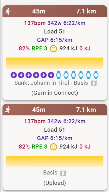

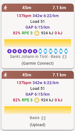

@david — would it be possible to automatically detect when a manually uploaded .fit file is a duplicate of an already auto-synced activity, and merge the missing data instead of creating two separate workouts?
