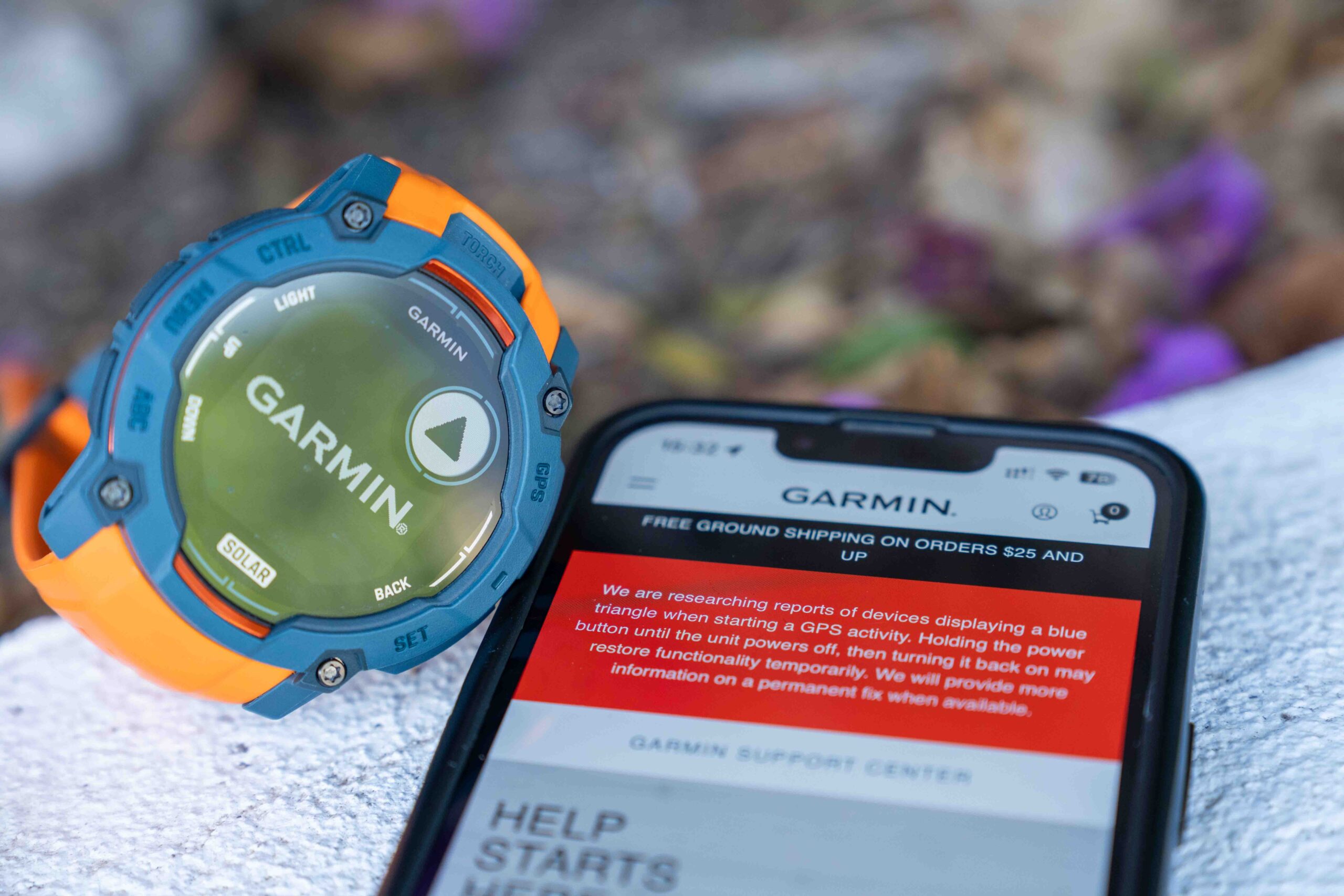

Hi, just wanted to share an observation re Intervals.icu widget I use on my Garmin Forerunner 965. The widget seems to be causing the watch to get into boot loop where only unprompted reset helps to restore the watchās functionality. I had this boot loop 3 times today already and it seems to appear when I install Intervals widget from Connect IQ store and then try to log in to my account. Watch firmware version 22.14. Iāll report if I find out similar behavior without the widget too.
The widget is not part of the Intervals project. It is a user developed IQ widget.
You better post your questions in this thread here to get in touch with the dev:
Thereās a few issues of rebooting/triangle of death with beta 22.14 reported on the Garmin forum - 965 forum. May or may not be related.
And also this - Garmin down? Reports surface of many Garmin watches crashing ā are you affected? | TechRadar
Reports coming in from all over

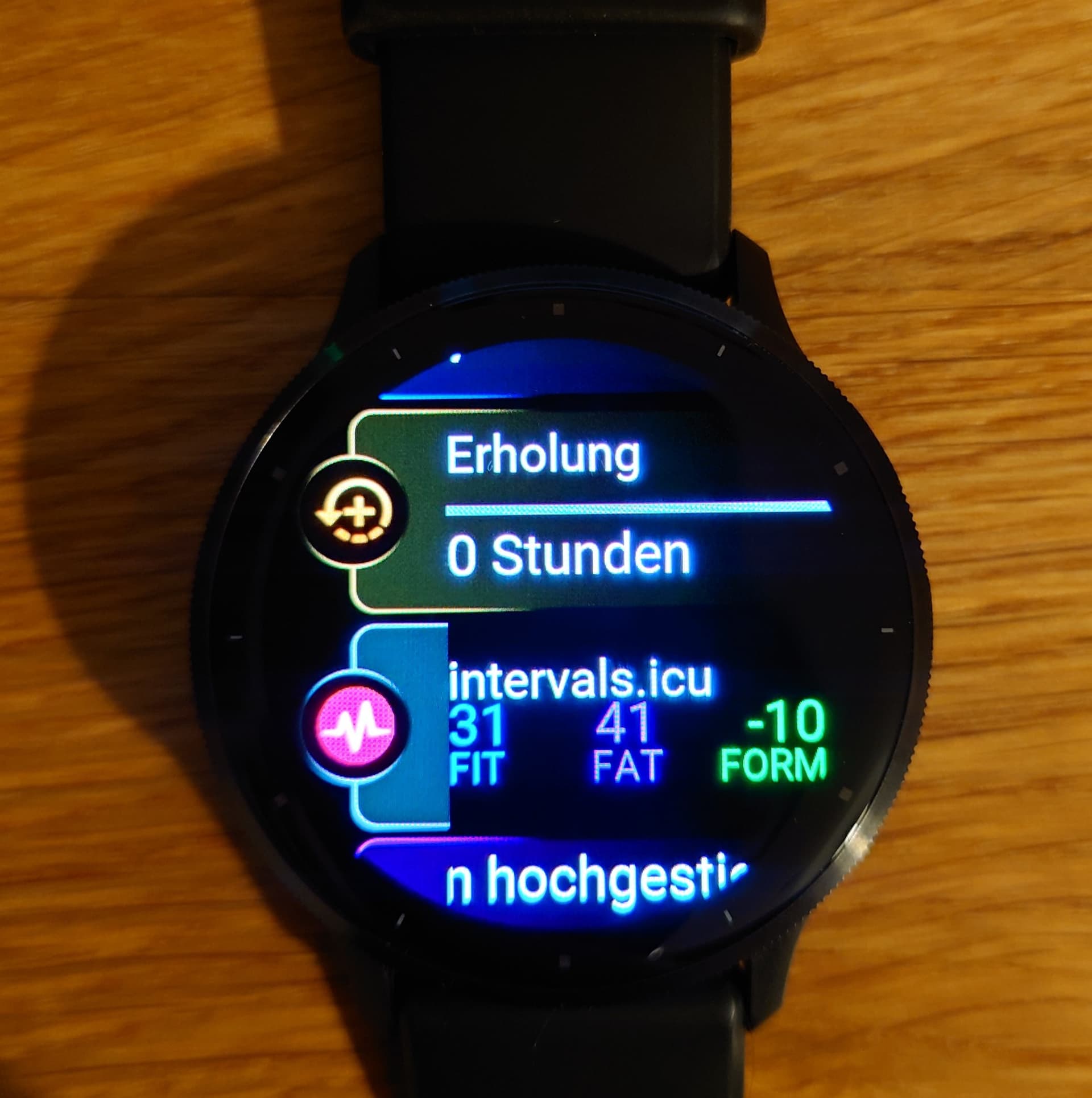

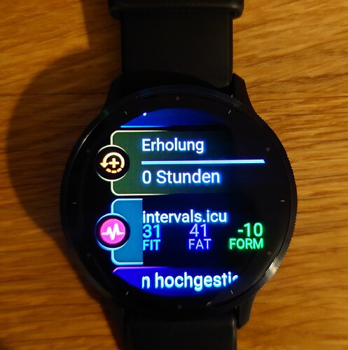

Hi, thanks for the awesome widget! I can now finally use it after upgrading to a Venu 3.
I noticed that in the layout of the Venu 3 the widget has a sharp edge on the left side, while all other widgets (including another CIQ widget) have the fading background. Is this intentional to keep the readability or would it be possible to include the fading background? My guess would be that maybe the background can be transparent and the watch itself will draw the fade behind it.
I havenāt put any code in specifically for the venu 3 other than simple adding it to supported devices, and then checking it works⦠so Garmin is applying that as a default. I will take a look next week if I can make it look like the others.
