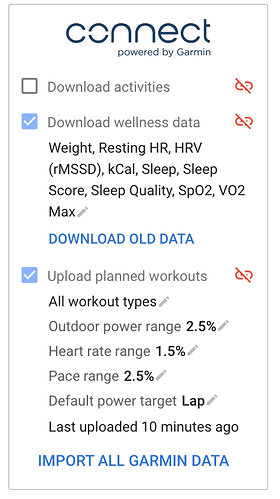

Hi David. I am new to intervals. I’m using it on Chrome. I read thru a lot of this thread and kept seeing discussion of connecting Garmin Connect so that my bike rides sync with intervals automatically. I never saw a chance to do that while setting up my account. Now the only way I can add a ride is to go to settings and use the Garmin connect download functionality which is very clunky. Seems like it should be simpler. Am I misunderstanding what is possible with auto sync? I never connected Strava because I prefer Garmin connect.
Curious - Did you enable it within the settings?
I used that Garmin connect but that opens a dialog box that has me request a download from Garmin connect. After Garmin pulls the data it sends me an email and I have to copy the link and paste it into the dialog box. Nothing about auto sync ever presents itself.
Which option are you clicking on specifically?
Note that the last link - “import all garmin data” this is for downloading of PAST workouts like maybe 1year(??).
the other 3 option boxes are for linking intervals to garmin. SImilar to how you link Strava to intervals or Garmin to Strava etc.
Ok thanks. I’m trying to get it to work. I figured out how to do what you’re talking about. It pops up a privacy window asking if I agree and then just sits there and spins. Sigh.
If it just spins that is likely a Garmin problem. You can try reload that page.

Hi @david I have a little problem. When i do the cycle activity automatically upload to intervals, its perfect, but i would like control when is this upload, because i change on garmin the name of the activity and put the RPE. Yesterday i change the configuration :
And today when i change the name of the activity and put the RPE i select the download activities, but the activity not appears, i dont know why? :weary: , i try to disconnect and reconnect to garmin but nothing… Any idea???
Unfortunately Garmin only provides the name of the activity and the fit file once. It is not possible to get future updates or RPE etc… Intervals.icu can read RPE and feel from the fit file if they are there but this is only likely if you capture those on the device before uploading to Garmin.

The procedure was:
1.- Deselect (donwload activity) on intervals settings.
2.- Do the activity.
3.- Change the name and put the RPE on garmin connect.
4.- Select (donwload activity) on intervals settings.
5.- Reload and wait the activity on intervals.
The problem was that after step 4 the actvity not sync.
Many Thanks @david!
Garmin are very strict with API requests to download old data. If the request covers previously used date ranges it is rejected. They want everyone to use their “push” updates which sends new activities to Intervals.icu very soon after they are uploaded to Garmin Connect. This push includes the name of the activity and the fit file, thats it. So if you wait a bit before renaming it is quite likely that the old name is sent. There is no update of the name after that.
So this is probably why your activity didn’t arrive. The easiest solution is probably to just download the fit file from GC and manually upload it to Intervals.icu.
