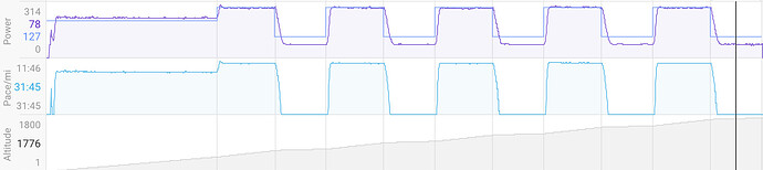

What is the metric intervals.icu uses to show GAP? The charts are showing a gradient, but GAP is not showing up.
What’s missing on the .fit file? Is intervals relying on latitude and longitude ? I can get GAP if I run with an incline on my treadmill while connected to Zwift and I sync the .fit file from zwift, missing latitude and longitude is my only guess on why intervals is now thosing GAP, please advise.
Intervals is using Strava’s GAP to model IIRC (there’s a thread somewhere if you do a search. Has been explained).
SInce you’re on a treadmill, (and a non-smart one I presume) you’re not gonna get GAP since there’s no incline being recorded. You didn’t share what you’re recording your FIT file from (if it’s a watch then it makes sense as indoor run has no GPS and thus no alt data. Either from GPS or Baro)
Zwift will have the data as it encodes the Virtual route (GPS w/ altitude data)
Having said that, your screenshot shows there is altitude data. How did you get altitude data recorded?
For GAP you need both an elevation and a distance delta on a second per second base.
LatLong will give you exactly that.
If the Zwift fit has second per second LatLong with elevation data, it should give a GAP result, I think…

I am using QZ - qdomyos-zwift to record pace/incline coming from my treadmill (using FTMS Bluetooth protocol), I am using a strydx pod to record power (also connected to the QZ app) and a heart rate monitor connected to QZ app.

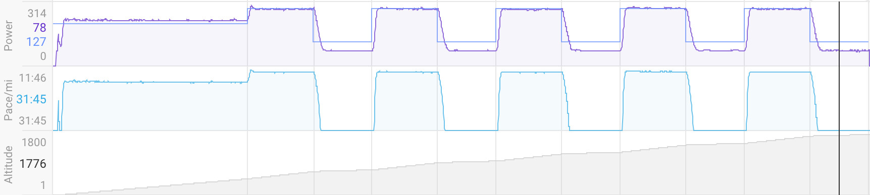

I found a way to get GAP with my current setup in intervals (please see screenshot):
What I did to get it working, I used one of my previous runs in Zwift, with the same incline I was planning on using, in this case 10%, grapped the GPX and loaded that GPX into the QZ app.

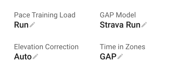

In SETTINGS, you have set the GAP Model?
Screenshot 2024-08-14 at 11.10.21 PM
Hi, thanks for your reply. I had set those as you show, but it doesn’t work.
