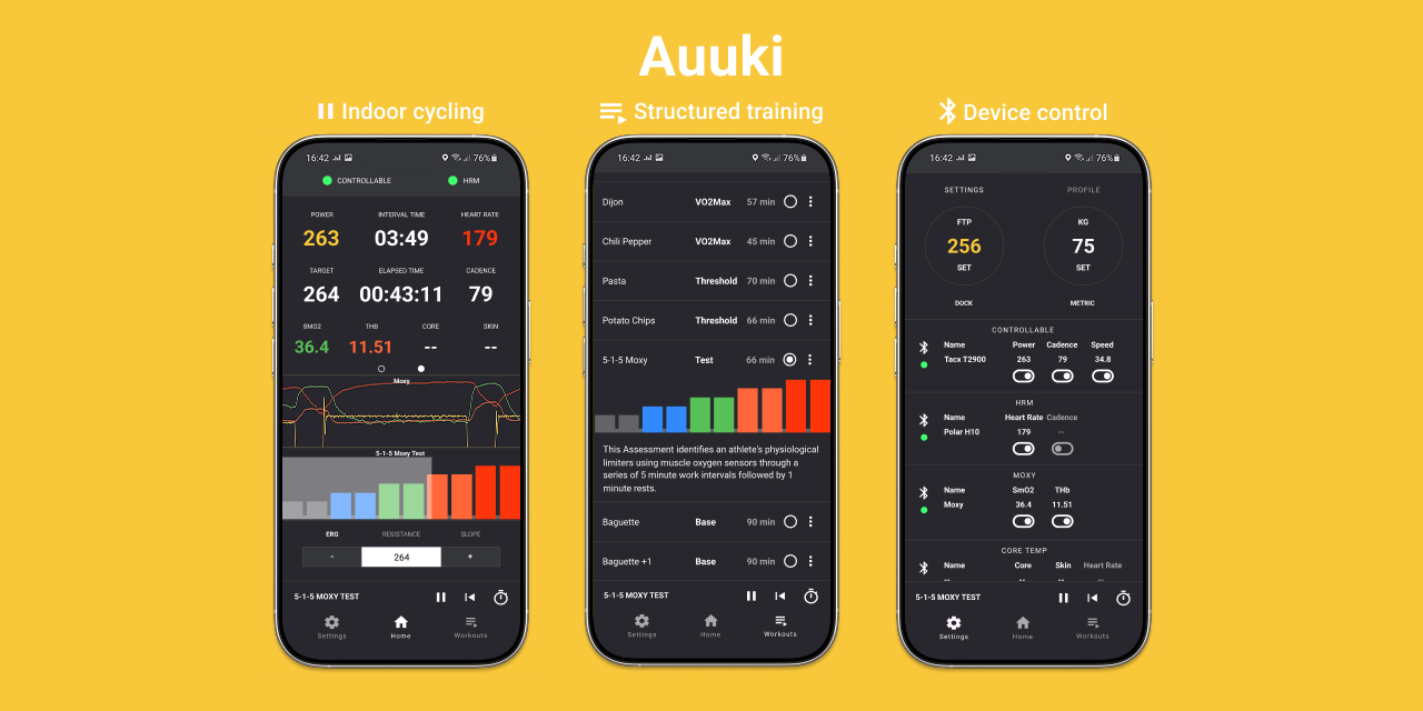

Fully web-based cycling training app.

Hey @ZeeZeeTop, the developer of Flux here. While some of the features like ANT+ connectivity are experimental the core of the app is pretty stable, I’ve been training with the web app for the last 2 years. Let me know if I can help with something!
