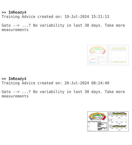

Also on the last two days I’m getting a message from ImReady4 that I have no variability in last 30 days but it’s obvious looking at the chart that I’m missing only RHR for the past two.
@Inigo_Tolosa
+1, ImReady4 is also how I realised about the issue. It started for me yesterday, too.
I’mReady4 is working perfectly but won’t work if rHR isn’t populated along with rMSSD
+1 - same here … ImReady4 reporting “no variability in last 30 days” :frowning:

Manually enter a rHR for the days it’s missing on Intervals and retry ImReady4
