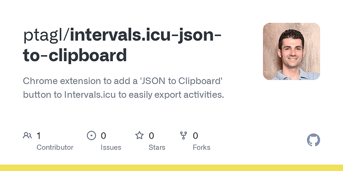

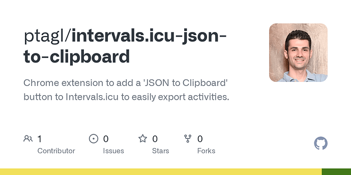

As this feature request doesn’t look very popular at the moment, I developed a basic extension that adds a “JSON to clipboard” button on every activity page.
Once clicked, the activity data is exported to the clipboard in JSON format.
It is way better than my previous manual approach, as the AI can now analyze every piece of information.
The extension is currently available on GitHub, but I will publish it to the Chrome Web Store as soon as possible.

For your information, the extension is now available on the Chrome Web Store:

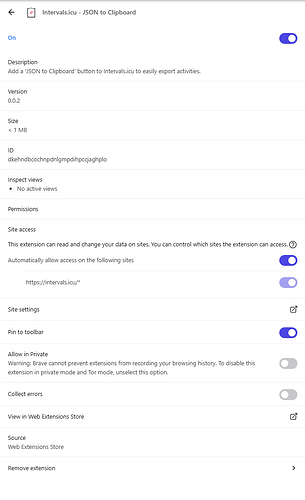

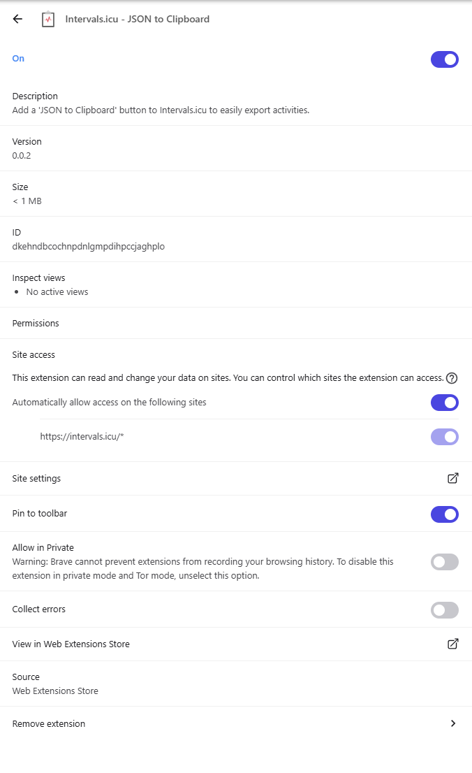

I have an issue! When I leave intervals.icu, the extension is disabled..so i have to open it and change the status from site access and reload the page
@dimitrios_adraktas thanks for the feedback and for reporting the issue.
On my side, I noted that sometimes I need to refresh the activity page to make the “export” button appear, but I never had to touch the extension settings.
Can you please check if you have the same settings I have on my browser from the attached screenshot?
What do you mean by “disabled”? Is it the first toggle at the top of the settings (ON/OFF)?
Can you try refreshing without touching anything else and see if it appears?
Thanks for the update. I have the same settings. I tried to refresh the page only and it’s appeared..

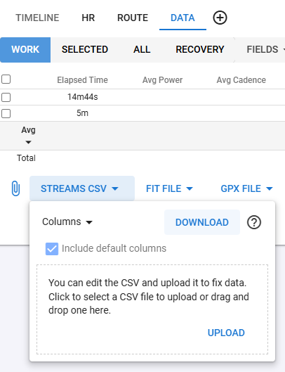

I installed the extension, thx for sharing. It works as well :slight_smile:. What is the difference to the CSV Data export and putting the CSV into Copilot for analysis?
@Chrigu_F thanks for the feedback!
Are you referring to the CSV download button that is available to export several activities at once?
That button basically exports a table containing a summary for each selected activity (e.g., time, distance, average values, etc.), while the JSON export button provided by this extension extracts all the available information, including intervals detected during the activity, power and HR zones, and other detailed metrics.

Interesting answer by Copilot. I need to double-check, but first, I have to understand better how you generate the CSV export.
Are you using the approach described here?
Not excactly like that. I use the csv download in the activity, then drag and drop to copilot.
I got it now! The Streams CSV download provides a “raw” file containing the original data registered by your device (e.g., bike computer, smartwatch, etc.). This is basically the input used by Intervals.icu to generate the activity report page.
The JSON export, on the other hand, provides recap data generated from the analysis of the raw CSV.
As an example, you can see that the Streams CSV file doesn’t contain power and HR zones, intervals, metrics related to normalized power, calories, fitness, fatigue, etc.
From my point of view, they can be used for different purposes:
  • Streams CSV - Use it when you need to re-analyze the activity from scratch; if you pass it to Copilot, basically, it would need to re-do the same analysis already performed by Intervals.Icu, but it would be tricky as the file is typically hundreds of kilobytes, and the AI may have quite a hard time handling the whole context.
  • JSON Export - Use it when you want to make a higher-level analysis, as the AI is your actual coach, and you want to check if the activity reflected the training plan, how you performed, where you can improve, etc. The JSON export is typically 90% smaller than the Streams CSV, making it easier for the AI to handle the context.
