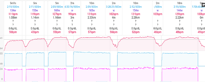

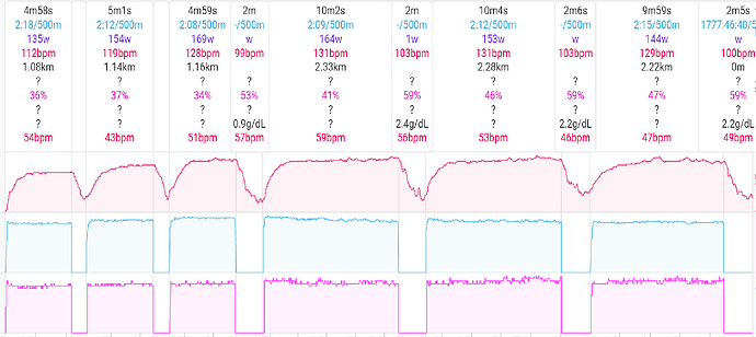

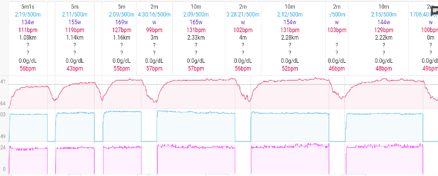

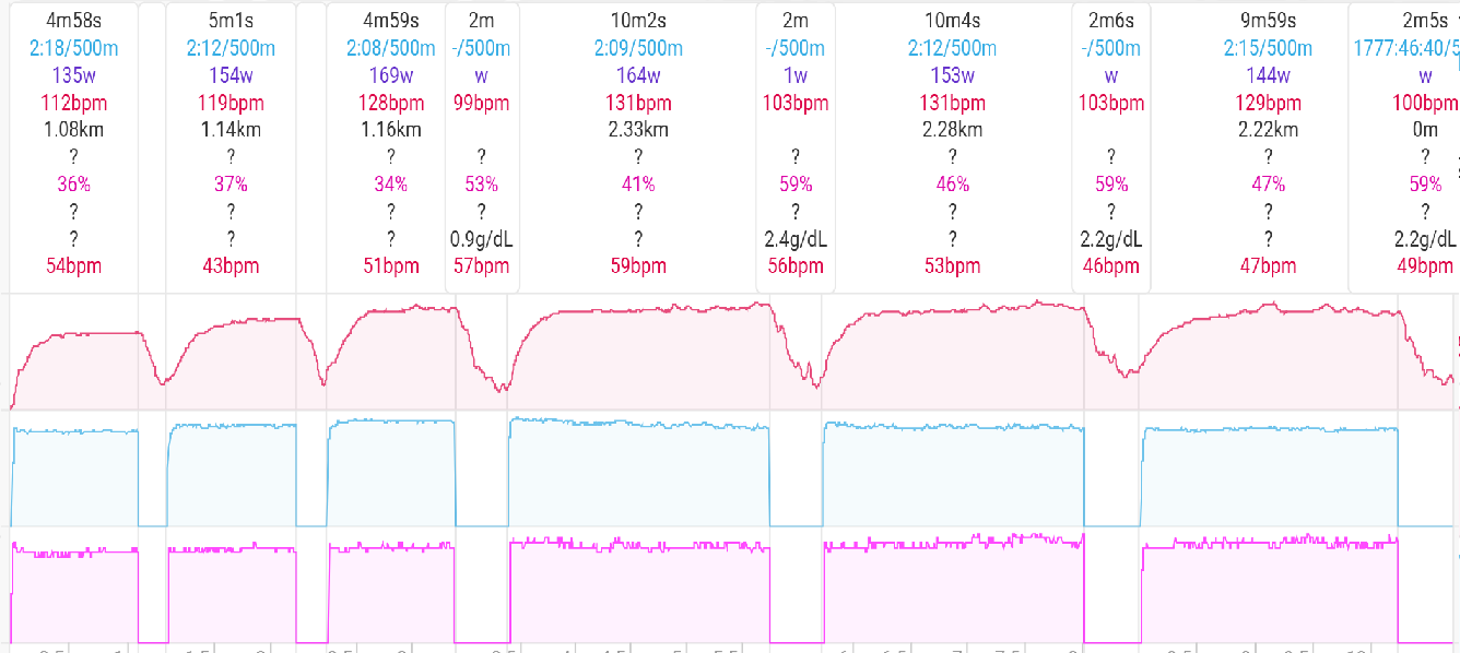

I have started having to use gotoes to merge my Ergzone FIT with my Garmin FIT to get Tymewear metrics. I have tried to connect both garmin (via ANT) & Ergzone (via BT) to the PM5 but without success. So other sensor integrations would be useful.
Fit file from Ergzone
Fit file from garmin fenix 7s

Now, there are two things I noticed between the two files:
  1. There is exactly a 1W difference in both Normalized Power and Average Power.
  2. Neither file “recognizes” the full workout duration. In this case, it shows 44 minutes, but the full workout was actually 55 minutes.
