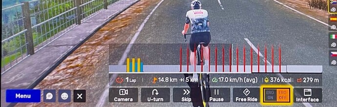

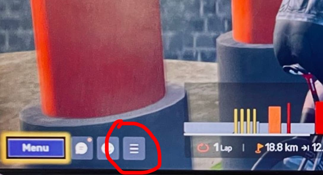

MyWhoosh has the option to disable erg mode while in a workout. Then you can change gears, stand up to “stretch the legs).
Use the triple line button to open a toolbar.
Toggle erg on/off.
Edit: don’t select free ride, as your workout will be disabled.

Thanks Gerald, I think this is the best solution, I was considering of adding something like:
- 1m freeride
between steps, but disabling the erg is way better and more flexible as you decide when to do so.
