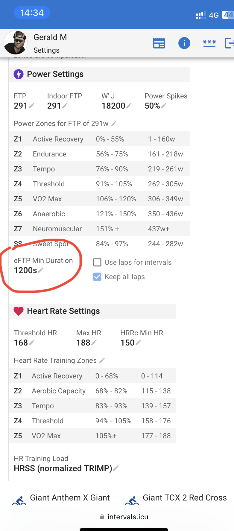

Go to your settings, and look for the value:
Got it, thanks! Mine says 300s.

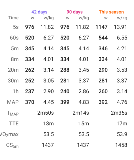

What do you recommend for the eFTP min duration setting? Mine is at the default 300s and I noticed yours is at 1200s. I am training for crit racing so most of my races are in the 45 min to 55 minute range. Does that make a difference with what I choose? The fact that I am interested in a lot of power but for a shorter duration? I ask because I get different numbers depending on what I enter. Three minutes through nine minutes is the same, but it starts to drop once I hit the 10 minute range.
It’s not so much dependent on the type of racing you do. It’s more dependent on your personal power profile. If you know that you have a higher then average anaerobic capacity, it’s better to lengthen the duration setting. That’s to avoid getting a overjudged FTP caused by your better anaerobic performance. Short durations of 4 min and less will be skewed by your high anaerobic capacity.
If, on the other hand, you’re more a TT type with less anaerobic capacity, shorter duration will yield very much the same result.
If you see a drop of with durations of 10 min and higher, it’s probably because you’ve never done all-out efforts longer then that. 10 min is too long to be highly influenced by anaerobic. Maybe you did regular VO2max blocks but never longer durations at max effort.

As the others have already answered your question on what setting to use, I’ll explain why mine is 1200s.
I find that most of my athletes have an FTP that is set too high, possibly indicative of the anaerobic contribution on those shorter, but harder efforts. I’ll use 300s when I’m doing VO2 work in the last half of my build phase, as I won’t test FTP before the first A race race.

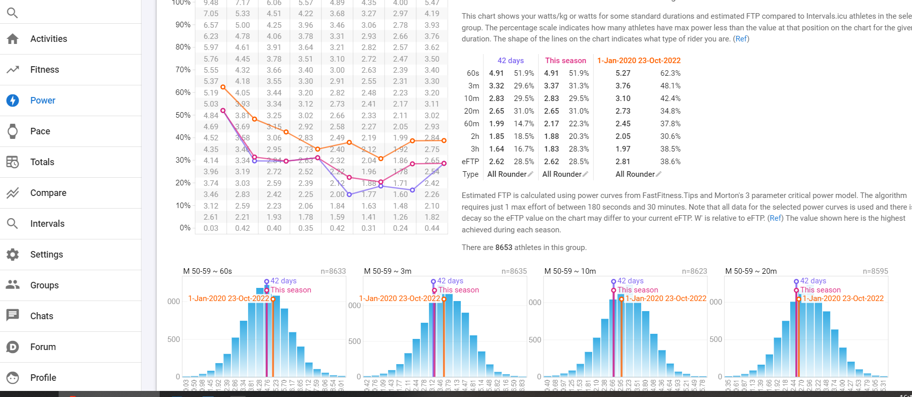

Thanks for the reply. Sorry if this is a dumb question, but how would I know if I have above average anaerobic capacity?
Intervals lists me as an “all-arounder” and WKO5 says I am a “time-trialist”
You do race crits, so you should know how you compare to others when accelerating out of a turn or sprint up a short hill. If you can easily stay in the front during the last quarter of those races, you are someone with a higher anaerobic capacity.
People who perform better around threshold or high tempo, will choose other types of events to participate in or will handle those crits in a different way. Longer escapes for example.
You can check out the Power page to compare to other Intervals users to get an idea too.

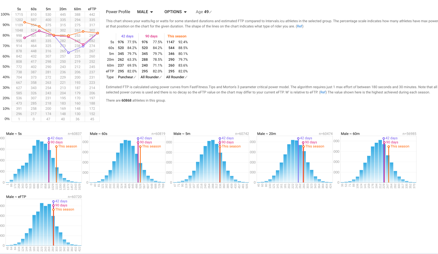

Here is how I compare to other males:
Also, I can usually accelerate away from the pack any time I want in a crit, but I can’t hold it for long. I also find short Vo2max and anaerobic workouts easier than longer threshold workouts.
If that is the case, would you recommend setting my eftp setting to ten minutes or longer since I am moving into my base phase and will be focusing on long sweet spot intervals? For example, I am starting with 4x15 at around 85% of ftp today.
You look strong all over the place in your age category :+1:
What if you compare to a younger age cat? How hard do you perceive those short bursts? Have you ever raced with a larger group of athletes that are considerably stronger then you? Were you gapped on longer steady efforts or during those accelerations?
All things that can help you evaluate what type of rider you are.

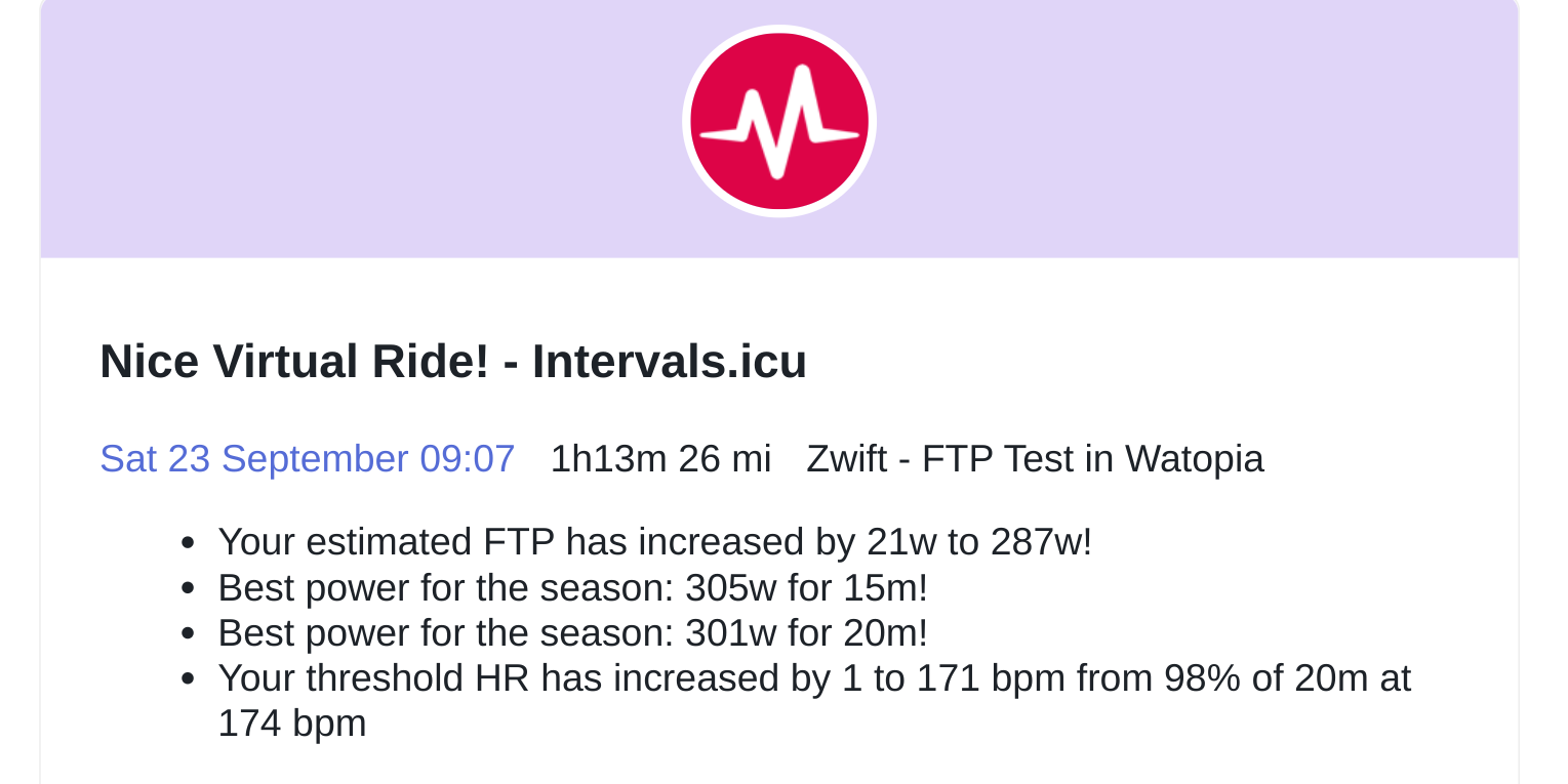

Quick update:
So my eFTP setting had been at the default 300s which gave me a 90 day FTP of 295. But since I think I lean more towards an anaerobic athlete and I want to focus on growing my TTE this offseason, I switched the setting to 1200s, which gave me an eftp of 266. Big difference. So long story short, thanks to your encouragement, I finally did my first ever 20 min FTP test (I have always used the ramp test or just used websites like intervals.icu that estimate it for me) and below is the email I just received:
