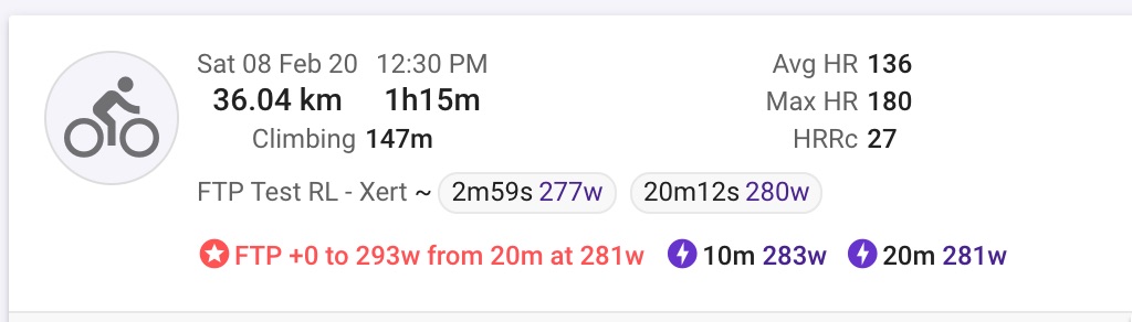

I just noticed that the eFTP seems to be giving wrong results. This used to be working correctly, but is now clearly not providing correct results.
On this ride, it calculated eFTP to 268, but now it’s giving incorrect eFTP = 293W, from 20’ at 281w?
I reduced the decay rate of eFTP but didn’t regenerate all the achievements. I think I had better restore the original quicker decay. That eFTP value is from a long time ago. It will take a few hours to recompute everything.
Yes, 293W FTP is from 2017, and I have been well below those numbers in last 2 seasons.
Anything to do on my side to trigger the regeneration?
It has regenerated yours but it still has you on 274w even with the higher decay. I suggest adding a “Set eFTP” calendar event say 1st Nov 2018 to a reasonable number. The decay side of this is very hit and miss.
