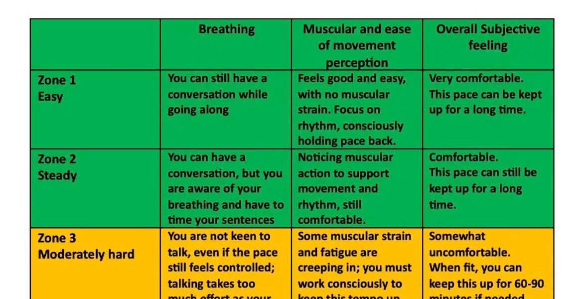

My suggestion, just start to perceive yourself and write down your effort based on RPE . So let the pace power/hr feed itself. Unless you have done physiological analyzes , both in this case and in the RPE , you can estabilish certain “limits” for example in easy days do not exceed X Hr value , because variables suach as feeling better on the day to be more recovered , heat etc… Probaly interfere , and in you´re going to do a light day , because the next day it should be be a Hard day , maybe you dont want to exaggerate.
