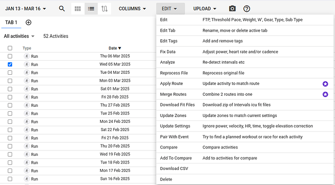

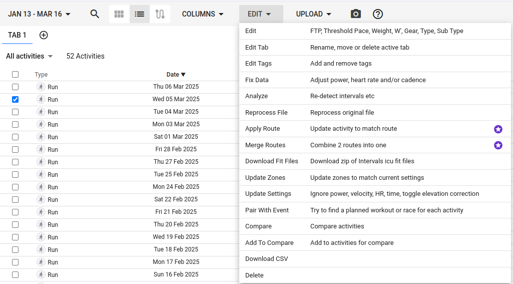

Go to List View, select then download

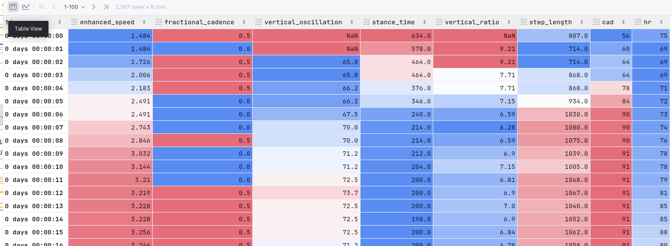

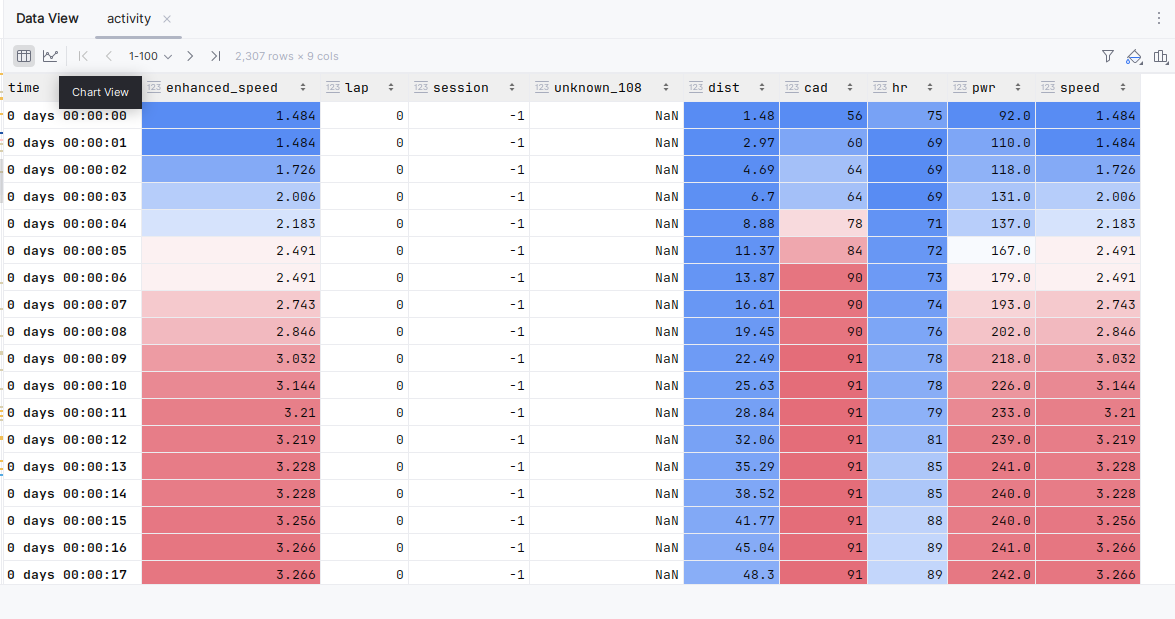

I did, and then I see it’s a much smaller FIT files in terms of size when comparing, and it even
Depending on how you sync data to icu you can connect dropbox, icu syncs original files there.
when I download individually it can download the original file, but when downloading with a batch it gives only pwr and HR, and no running dynamics.

The list view only does download of ICU File files and not the original

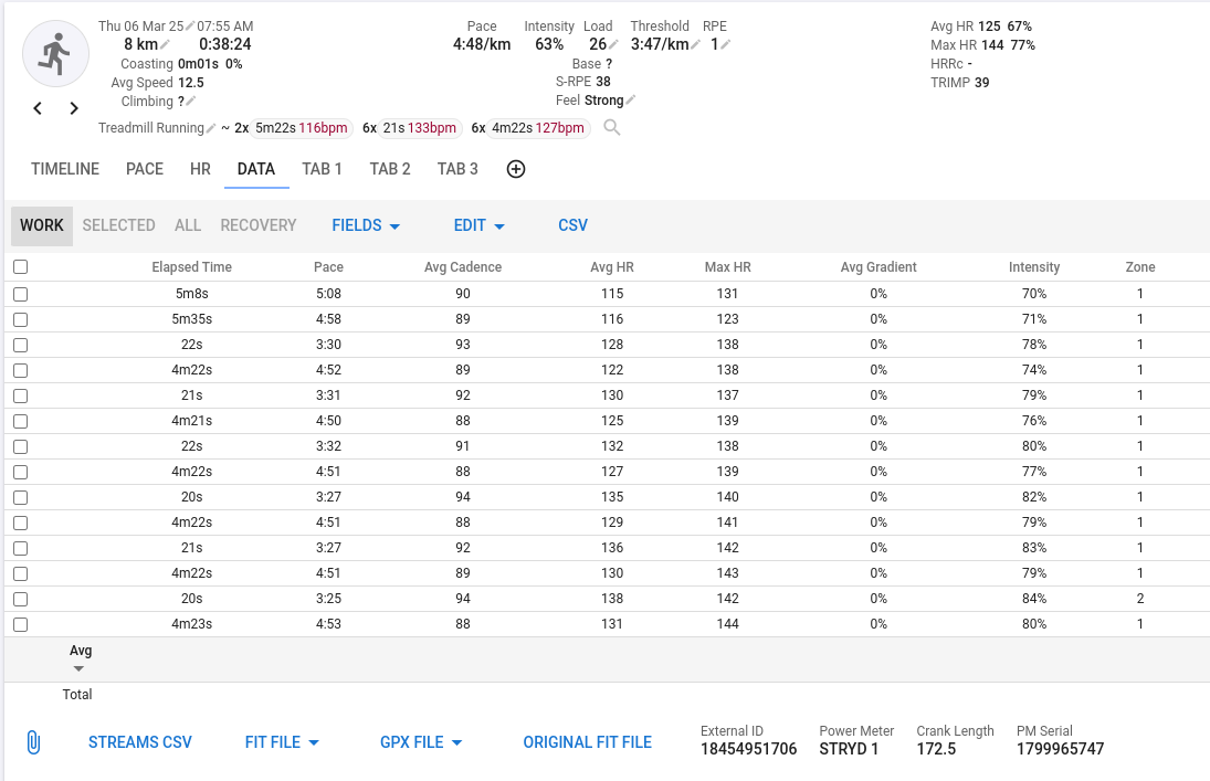

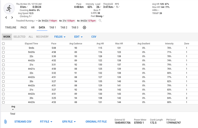

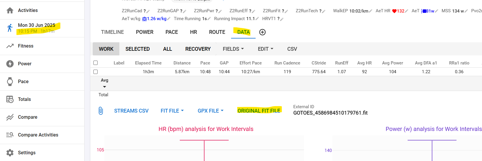

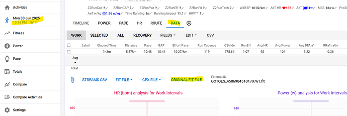

how can i download the original fit file?
Activity Data Tab
